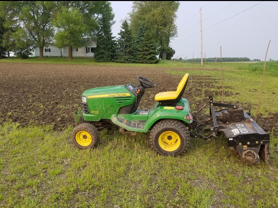

I had an old 2 acre hayfield that wasn't producing at the time. I only had 2 atvs at the time so I brought home a garden tractor with a tiller from work.
It took most of the weekend but I got it worked up.
I did find a bigger rock half buried and the tiller hoped over it.

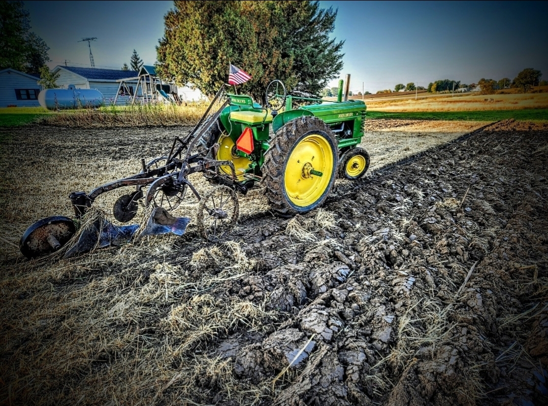

I think a tiller would do the job but would soften the soil too much and and maybe cause a low spot or sink hole.
I like to play farmer. I think a plow would bring up the soil and fill in the ruts but then you got ocean waves.

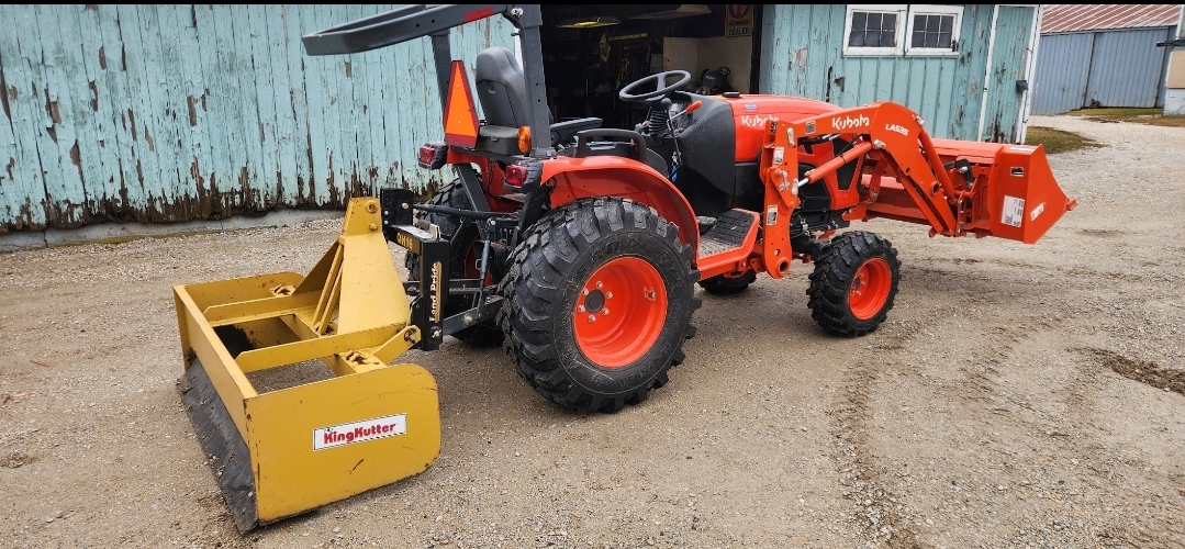

A box blade you'd have multiple uses for and could use it to level out and fill in the ruts, plus it has shanks too like the cultivator.
I had an atv disk I used befor the tractor. I had to add extra weight to make it work. I agree with others if you want results you need a heavy duty one and multiple paces. I really liked the results of mine but it packed down the soil to where I was losing production.
If I could have only 1 tool for the job. I'd get a box scraper. You can fix your gravel driveway in spring, level out the ruts, regrade your lawn, and use it for snow also.
