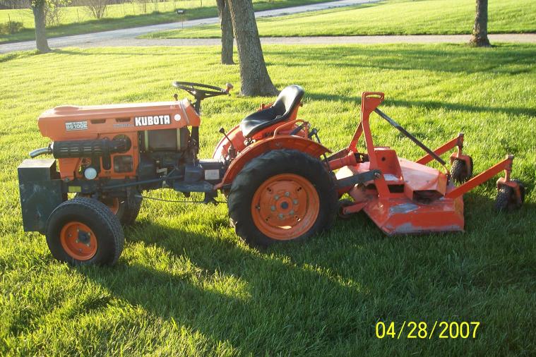

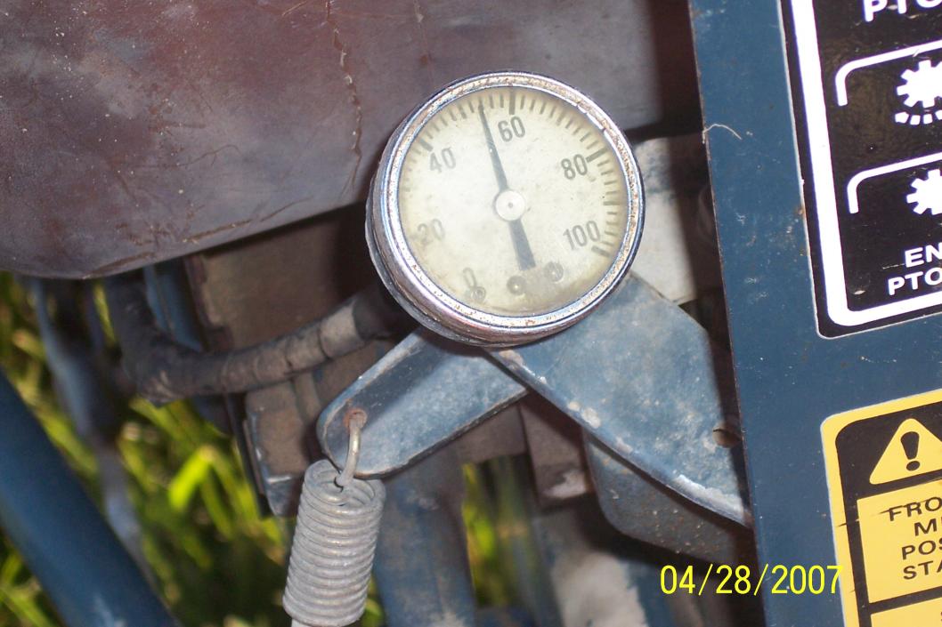

I had a B6100 that was very limited on space. I got a oil pressure gauge from a Harley shop since it was made for outside use and was smaller then 2" dia. Here's how I mounted it. A homemade bracket down low out of the way, mounted in an existing hole with a line going over to where the sending unit screwed into the block.

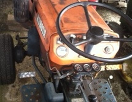

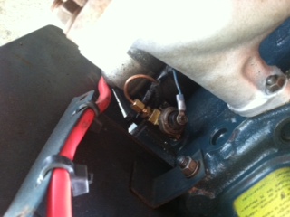

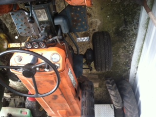

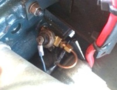

not having gauges on my b7100 is my biggest hang up for the tractor. this is how I added some to it. oil pressure, volt meter and temp gauge. I bought the triple set from auto zone for 29.99 1.5 inch faces on the gauges and a brass tee so I could also keep the oil pressure idiot light.
sorry the pics are upside down computer refused to work with me on that

Steve,
here your pictures turned for you, nice job!

85Hokie, thanks for that. I got a chiropractor appt. set up for Monday after trying to study those pictures!
Steve, nice gauge setup.
