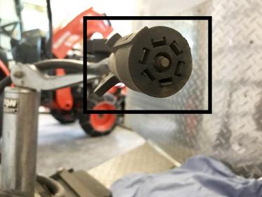

Sheep farmer, I'm gonna add to what Shaun said about the trailer. Your gonna have two common plugs your gonna come across.
The 7 pin rv plug and a 4 flat. If it has electric trailer brakes, it will have a 7 pin rv plug. If they have one with a 6 round, I'll post a picture of me eating my hat :)
If it has surge brakes, you have a 50- 50 shot of the plug still being a 7 pin rv plug or a 4 flat.
If you have a 6 round plug on your truck, you can get an adapter from 6 round to 4 flat. Or 6 round to 7 rv. The latter is a little harder to find, so you may have to order it in.
You can also get adapters from 7 rv to 4 flat. 7 rv to 6 round. Or you can get an adapter that goes from 7 rv and will handle all the different plugs.
First picture is the 7 rv plug. Second picture is the 4 flat.
3rd and 4th pictures are of the adapter from 7rv and will handle the 6 round as well as 4 and 5 flats.
You can get a 7 rv to 4 flat adapter for less then $20 at most auto parts stores. :D

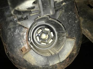

Fabulous! I knew I could count on you guys for helpful information. Daren, I went out and looked at the socket and plug and it is some kind of 6 pin connector. It was installed by horse trailer store when both were new, 2003. So I am betting an adapter is needed. Edit: that might not be right. By 7 pin do you count the middle one? Mine looks like your first pic. Will attach picture.

This would be the 6 pin.
They use the round terminals and the 7 pin uses the flat terminals. 6 pins are pretty rare,I usually see them on big utility trucks.
And yes the middle pin makes it 7. Pretty much the standard for all pick ups along with the 4 pin.

Thank you. I am slowly catching on.
