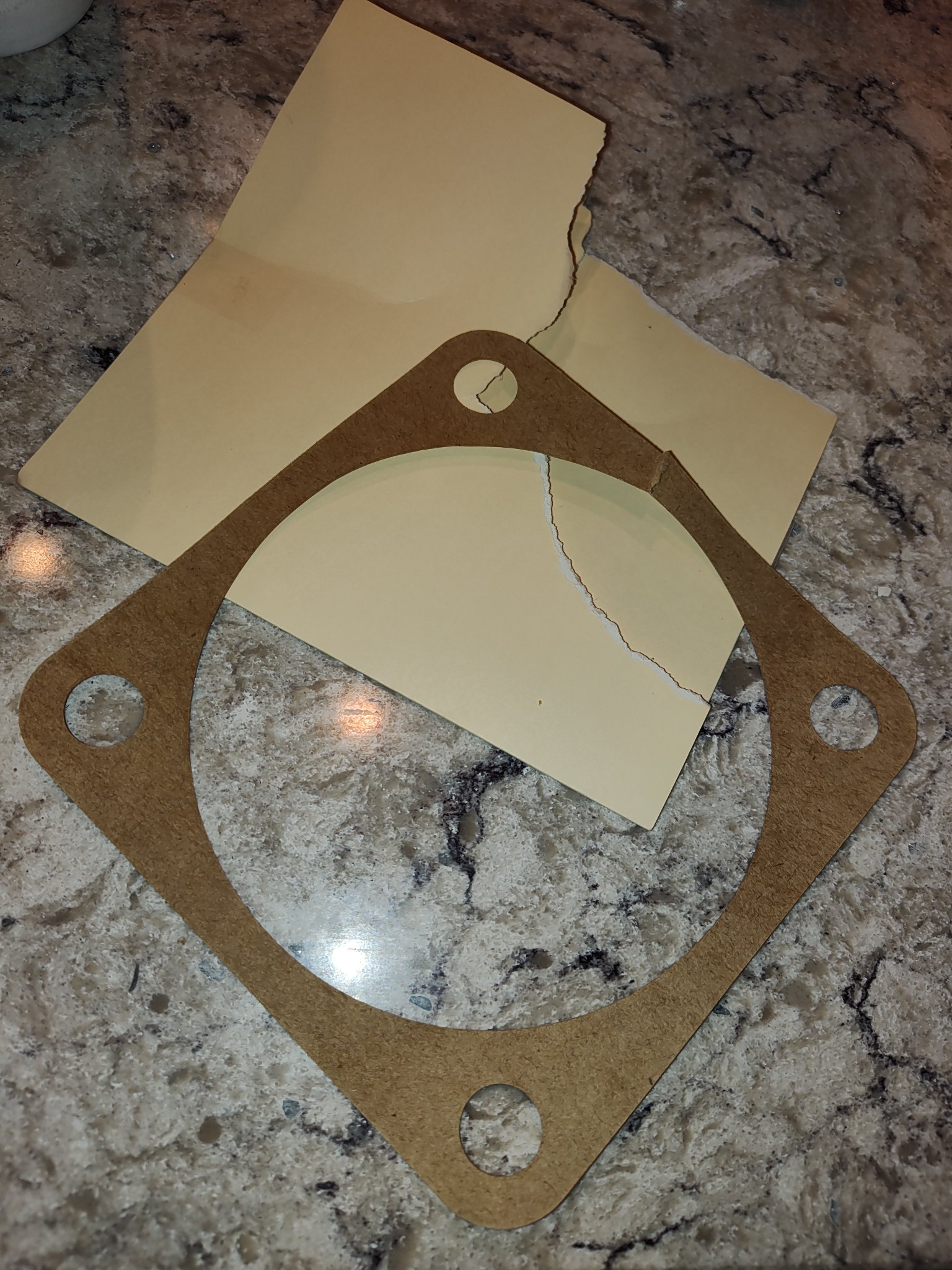

After months of stop and go progress getting my Woods Dixie Cutter back together from changing out the lower bearing, I was finally ready to reassemble and realized there was no gasket between the front shaft bolt on plate and the gear box. I ordered one about a week ago and it finally came. Well, one of my boys decided to be helpful and ripped open the envelope/folder the dealer shipped it in. It was a $5 gasket and about $8 to ship it. My question is if I'm using Permatex and put the tear at the top, will I be ok to use it or do I need to order a new one?

Use it and if it leaks, then order a new one. I bet that it will be fine.

Use it.
I've had a few vehicles in my past totally leak free using Permatex and carefully cut "gaskets" from Cheerios, Triscuit, Cap'n Crunch, etc, boxes.
Not that I recommend it. But in a pinch...
It it were me, I'd find some comparably thick card stock. Cereal box, shoe box, etc. Take your new but ripped gasket and trace it on the card stock. Use a sharp X-Acto blade and make a new gasket. The local auto supply should sell gasket material too if you are so inclined. But use Permatex either way.

Use it.

I used that cereal cracker box trick long ago too. Made a couple water pump gaskets for my old rambler in the 70's. Guess we are from that same era and mind set of this will get it going.

Great teaching moment. Teach your boys to not open anything not addressed to them. If you don,t need that piece of equipment right away, I would order a new one.

I've used 'cereal box' gaskets many times in the past. They've (almost) always worked well.

My Grandad showed me the "box" gasket trick when I was about 12 on a blower for a feed truck. He laid a piece of box on the one mating surface and very gently tapped the edges with a tiny ball pein hammer to cut the thin cardboard. He's one of the few people I still miss and he passed in 1968. My eyes got a little damp while tying this.
My dad did a very similar thing. We (I was the designated watcher) rebuilt an inboard engine when I was about 10 or so. I still remember him using a small hammer on gasket material held down on the surface.

Using a small ball peen hammer was/is a common tool to make gaskets. Lay the material over the area and tap the edges and tap the ball at each bolt hole. I've used roofing paper!
