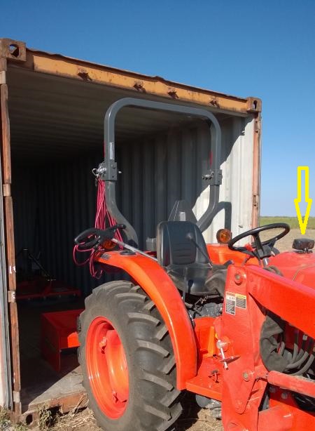

Rolling over backwards is a function of center of gravity and angle of attack.
If a hill is at 30° and your tractors CG critical point is at 45° (just for arguments sake), you only have 15° of tilt you can 'play' with and if you wheelie, all your play space is gone in a second. What you'll find is that at about 5-10° near the CG critical point, even the slightest weight shift (only a few pounds) can take you over the limit faster than you can react. This applies going uphill or sideways. My L3200 with the FEL about 1" off the ground and filled tires with a medium spacing on the rears can only handle about 20° of side angle before it gets very squirrely and unsafe feeling. That is why I now have one of these mounted on my tractor:
Clinometer
