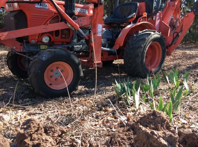

I just bought the front tires, and was hoping to still be able to use a 29x12.50 in the back. I was wondering if there was any binding or anything.

I drove it around a little yesterday and didn't notice any "binding". Keep in mind I really don't know what binding looks, sounds or feels like. Tractor drives the same as it did before.
