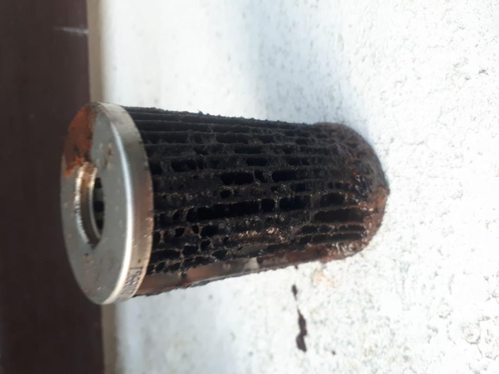

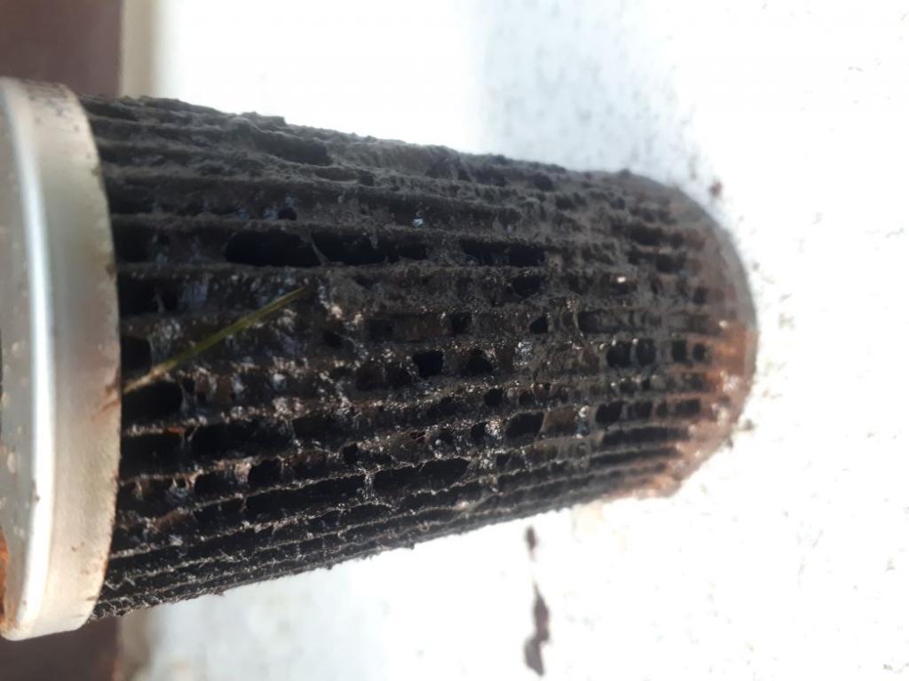

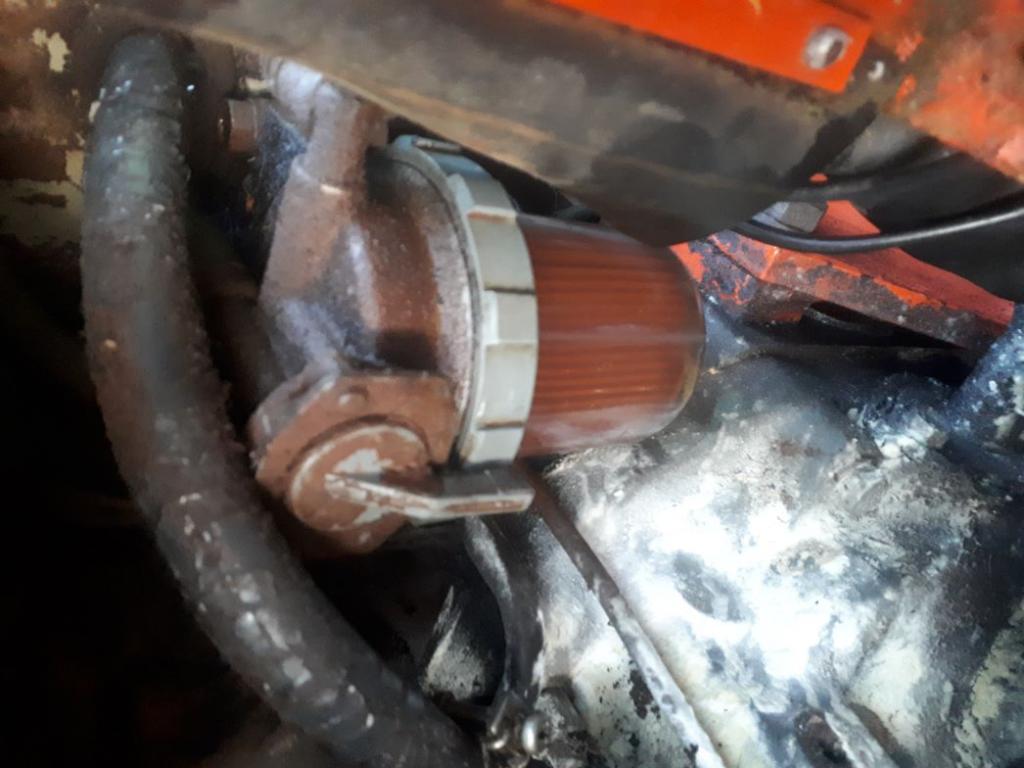

1. fuel filter
2. fuel filter
3. all shiny new
Ah sure maybe they'd have been ok for another 30 years :eek:
