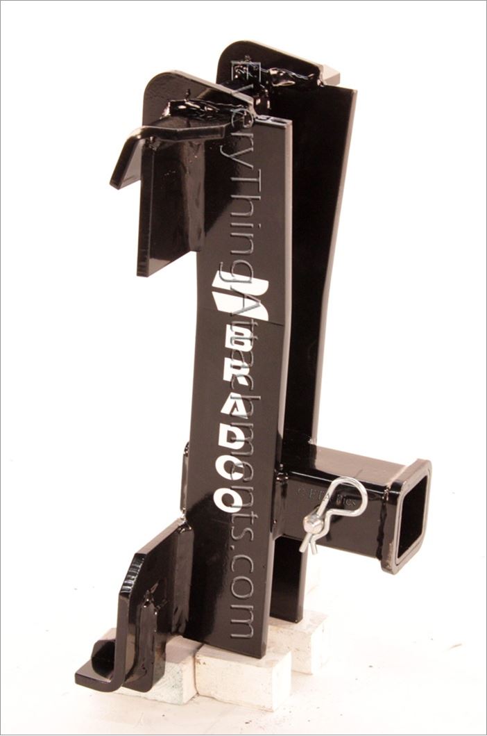

I have narrowed it down to two options;
The Titan Trailer Hitch Receiver For Pallet Fork Frame, $80.00
https://www.palletforks.com/trailer-hitch-receiver-for-pallet-fork-frame.html
The Everything Attachment Bradco version of the same, $326.00
https://www.everythingattachments.com/Pallet-Fork-Trailer-Hitch-Receiver-p/pf-trlr-hitch-100899.htm
What I'm I missing here with this wild price difference?

You're not missing anything. One uses much better steel and much prettier welds. The other was made in China. However, if you're not a commercial business that was using it everyday (lake hauling boats out of a lake at a marina) I'd just spend the $80 and be happy with it.
I do highly recommend everything attachments, but not at 4X the cost for a 2" receiver. Just wait till you hook up your first trailer with the loader, you'll be amazed at just how much control you have with it.
Best of luck.
Edit: I just noticed that it looks like both of these units are supposed to attach to one side of the SSQA? That, I would not do. Get the titan forks with the receiver already on the mount. You'll be surprised at how frequently you use the forks as well.

No, they attached to Fork frame not the SSQA frame.
As I understand by attacking to the Fork Frame, yes a little off center; it will still spread the wight out across the SSQA/lifting arms?
Is the concern of the weight being on one lift arm more then the other or is it having the hitch a little off center?

Ok. That makes more sense. On first pass, it appeared to me that it only attached to one loader arm. That was my concern.
Since you already have a set of forks, are they SSQA and can you remove the forks? If so, why not find a friend/neighbor with a welder to tack on a 2" receiver bracket? Think of it like a bumper pull receiver mount...
something like this...??? https://www.harborfreight.com/5000-lbs-step-bumper-receiver-69670.html
Cheap and easy if you have access to a welder.
3,298
4,543
I suppose it could....however, doing it that way would severely limit how much tongue weight you could safely handle....you'd need the ballast in the loader bucket. I certainly would not want to do that. The backhoe makes for almost 1000 lbs of ballast on the rear of a B2650. I'd want the hitch up front.
