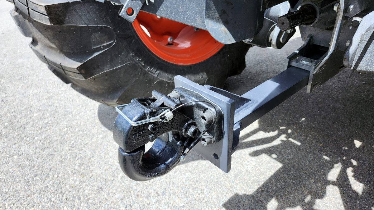

The drawbar on my MX is 2.25"(W) x 1.25"(H) and the drawbar on my M6060 is 2.5"(W) x 1.25"(H). Even if you use A36 mild steel with a dismal yield strength of 36,000 psi, the force that the drawbar can withstand in shear is HUGE! It's a simple calculation where the force = yield stress (lb/in^2) x cross sectional area (in^2)
The tongue weight from a trailer is never going to shear the drawbar so I see no problem pulling a trailer using a hitch ball. I have a spare drawbar for the M6060 to use with the Land Pride folding cutter, but I converted the original drawbars for the MX and M to be used with a lunette ring or any other trailer or implement interface. It's a simple case of bolting a plate to the plate on the drawbar with whatever is needed at the time. Obviously the drawbar can be flipped over to accommodate different coupler heights.
