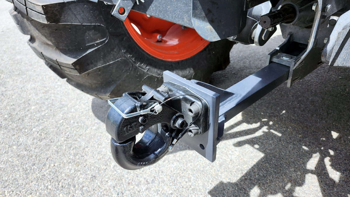

The drawbar on my MX is 2.25"(W) x 1.25"(H) and the drawbar on my M6060 is 2.5"(W) x 1.25"(H). Even if you use A36 mild steel with a dismal yield strength of 36,000 psi, the force that the drawbar can withstand in shear is HUGE! It's a simple calculation where the force = yield stress (lb/in^2) x cross sectional area (in^2)
The tongue weight from a trailer is never going to shear the drawbar so I see no problem pulling a trailer using a hitch ball. I have a spare drawbar for the M6060 to use with the Land Pride folding cutter, but I converted the original drawbars for the MX and M to be used with a lunette ring or any other trailer or implement interface. It's a simple case of bolting a plate to the plate on the drawbar with whatever is needed at the time. Obviously the drawbar can be flipped over to accommodate different coupler heights.
You're right. The tongue weight will never shear the drawbar, but it will BEND!
But not much. With the maximum listed drawbar load of 1,650 lbs (owner's manual) on the end of the MX drawbar (2.25" x 1.25") the maximum deflection for A36 steel is around .085", assuming 12" from the load to the root of the beam. That's not a whole lot.
The MX has a GCWR for a trailer of 11,130 lbs. There's no way I'd ever pull that much behind the MX. The M6060 maybe, but certainly not the MX. The M6060 has a GCWR for a trailer of 13,200 lbs.
