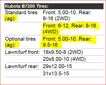

Kubota B7200 Tires:
Standard tires (ag): Front: 5.00-10. Rear: 8-16 (2WD)
Front: 6-12. Rear: 8-16 (4WD)
Optional tires (ag): Front: 5.00-10. Rear: 9.5-16
Lawn/turf front: 18x9.50-8 (2WD)
20x8.00-10 (4WD)
Lawn/turf rear: 29x12.00-15
31x13.5-15

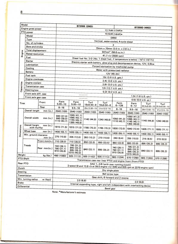

I logged into this forum to see if i could get a definitive answer to when and how you could run 9.5-16 tires on the back of a b7200, and now i am more confused than when i started. Where did you get the information that the front tire need to be 5-10 for the 9.5-16 rears? I have not seen the specs for the 5-10 tires but i am guessing that they are shorter than the 6-12. If they are shorter, why would you pair them with the taller back tire? That would make the ratio even worse. I dug out my operators manual for my tractor and it only lists the 5-10 for 2-wheel drive models. Am I missing something here? I am purchasing some replacement tires (9.5-16) and want to make sure i am not going to screw thing up. Was there a different gear ratio if the tractor came with 9.5-16's? My tractor is 4-wheel drive. If it was 2-wheel drive ratios would not matter.

try this site - notice the difference between 2wd and 4wd
http://www.tractordata.com/farm-tractors/001/2/7/1272-kubota-b7200-dimensions.html

I do notice the difference on the "Tractor Data" website. It is different than the data on the page from my factory Kubota owners manual. What information should i consider correct, the information supplied by my tractor manufacturer or the information supplied by a website? I would think that the factory that made the tractor would know what tires it could use. The factory owners manual only specs 6-12 farm(ag) fronts for a 4wd. There are no 5-10 farm front tires on 4wd tractors. What is the diameter of a 5-10 ag tire? i can not find how tall it is compared to the 6-12. If it is shorter then can you tell me why they would use it with taller rear tires? The ratio would would be worse with shorter front tires.

Well, first I am told that if I have 9.5-16 rear tires that I have to run smaller 5-10 fronts. Now I am told that I need to have a larger 5-14 front. Where is this information that everyone keeps giving out coming from? I know that just because something is a "Factory Spec" that does not mean that it is correct. Manufacturers do sometimes send out wrong specs. With that being said, can you tell me why you believe the factory specs are wrong? Kubota only specs a 6-12 ag tire for the front of a 4wd B7200D with 8-16 or 9.5-16 rear tires. Kubota does not recommend a 5-10 or a 5-14 front tire. I have done some math to determine the gear ratios for the front and rear of a B7200D. I use Kubota's online parts lists for all gear specs except for the 12 tooth rear jackshaft gear that I needed to find in my workshop manual. If anyone finds my math or specs to be incorrect please let me know and i will correct it. This is how I calculated the ratios. The rear trans shaft transmits power to the rear jackshaft through a 6 tooth pinion and a 37 tooth ring gear(6.16667 ratio). The rear jackshaft transmits power to the rear axle through a 12 tooth and 55 tooth set of spur gears(4.58333). The overall rear axle ratio is (6.16667 x 4.58333) 28.26388. Now comes the difficult one, the front axle. The rear trans output transmits power to the front trans output through a 16 tooth and 24 tooth set of gears(1.5 ratio). The drive shaft transmits power to the front axle through a 6 tooth pinion and 37 tooth ring gear(6.16667 ratio). The front axle transmits power to the bevel shaft through a 13 tooth and 14 tooth set of bevel gears(1.0769 ratio). The bevel shaft transmits power to the wheel hub through a 16 tooth and 31 tooth set of bevel gears(1.9375 ratio). The total front axle gear ratio is (1.5 x 6.16667 x 1.0769 x 1.9375) 19.3005. Front to rear axle ratio is (28.26388/19.3005) 1.4644. Tire specs very by manufacturer so I am using those supplied by Carlisle because that is what is on my tractor. A 9.5-16 tire is 33.5" tall, a 8-16 is 31.4 tall and the 6-12 is 23" tall. If you divide 33.5 by 1.4644 you get a tire size of 22.876 for the front(error of .54%. If you divide 31.4 by 1.4644 you get a front tire size of 21.442" (error of 7.266%). Given the math, the 9.5-16 tires are what should be on the tractor. The standard 8-16 rear tires give you almost 15 times the ratio error as the "optional" 9.5-16. This information is for the B7200-D. I do not know if it would be different if you have a B7200-hst. It may be the same but I did not verify it.
