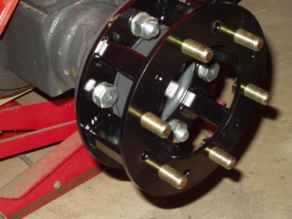

I recently ordered a pair of wheel spacers from The Tracks Company. I had them made to 3" and they came with all the hardware necessary for an easy installation. They looked to be well engineered and excellent quality. I believe they'll serve me well for years to come.

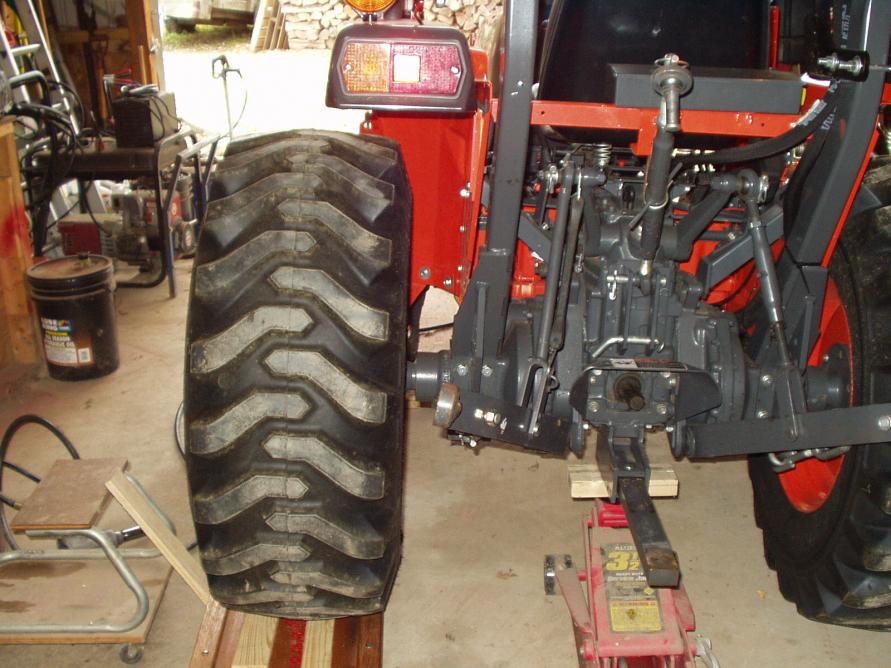

I was a little shy of trying to install the filled wheels myself but came up with a new use for my mechanics creeper. Although the tires are just a little heavier than me the creeper made remounting the tires a breeze with just one person.

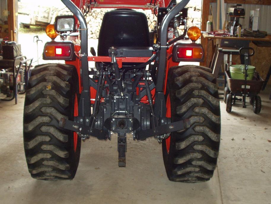

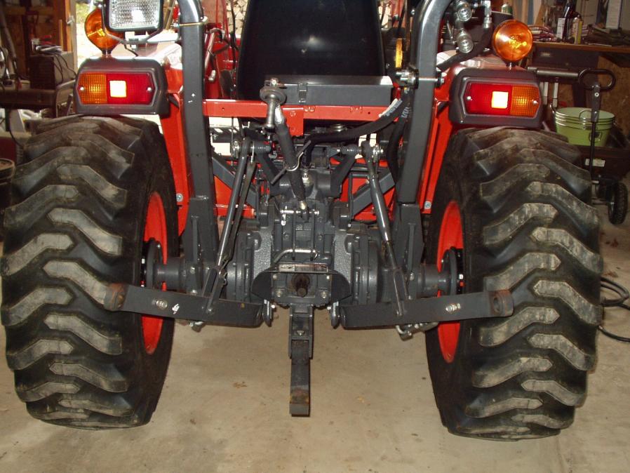

I went from a 57" outside width and 1" of fender clearance to 63" with 4" clearance. This should make the tractor more stable on side hill mowing and when working with the FEL.
This now allows plenty of space for winter chains.

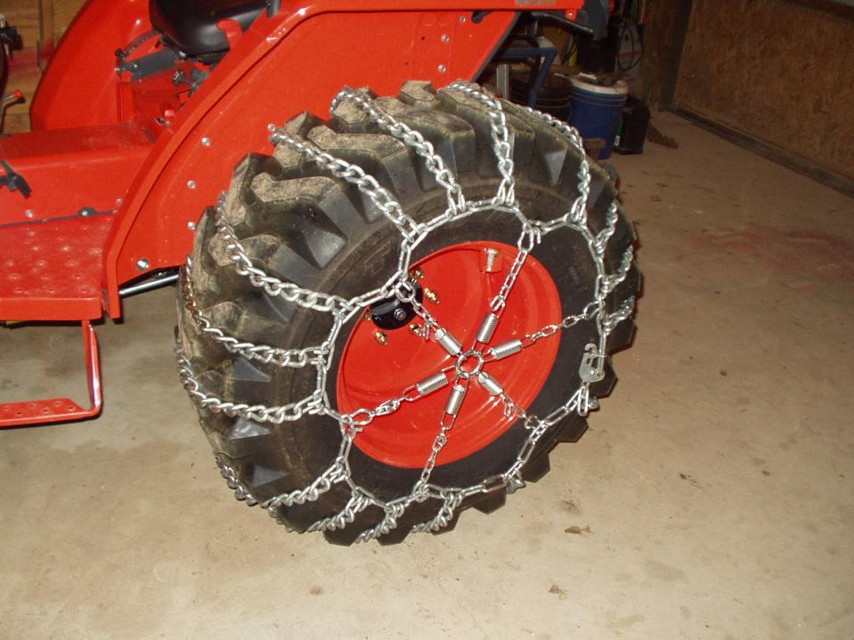

Speaking of chains, I purchased a pair a few years ago for my smaller B1700
They were 72" long and 23" across. The Tirechains.com company said my new chains for the L3700SU were the same width but I'd have to lengthen them some 28" to 100" long. I purchase the additional length side chains, tightener kit and installation tool and also the heavy duty chain repair tool recommended on here on OT last spring.
The HD chain tool was a work saver and the entire job turned out great with one slight exception. I only had to lengthen the chains to 85" total to fit the 15 x 19.5 Tires .
When I had the rear work complete, I swap the front wheels side to side and this gave me an addition 3" width there with no interference problems.
