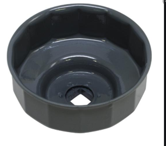

Wow, I have owned 8 tractors and numbers of automobiles that I have always serviced and am pretty experianced in removing oil filters. Got all my filters changed on the L3301 except the hyd. filter, it refuses to budge. I have broken 2 filter wrenches trying to loosen the filter with no results, even with a cheater pipe.o_O and pipe wrench.
Anybody got any suggestion other that hauling it to the dealer?
11,025
2,897
Have you tried the "cup" style with ratchet drive? I use those often - BUT most of the time I have to place a thin piece of sand paper inside the cup to get that last little bit of grip and I have to use a cheater bar.
If you don't have that .....
the straight blade screwdriver is next in line! Then again I have seen a chisel used to tape the outside metal flange to get it started too. Not to high on the chisel method - the screwdriver though usually gets the job done as the last resort.

Thanks for the tips, still not loosened filter yet. I don't have confidence in the screw driver as it will shred the filter as tight as it is. I do not have the chain wrench as yet but sounds like it may do it. Don't want to damage the old filter and not get it off.

Ok, filter removed and new one on. :) Tried all the wrench types, cup, band, ratchet, even borrowed a chain wrench and all it did was crush the filter. So found one of my older band type with a 1/2 drive breaker bar, cheater pipe and brother inlaw with BIG muscles and he cracked it loose. :cool:
As a side note, there was no screen to wipe off but instead a magnetic ring to catch metal, which there was little to none. All is well in Kubotaville now, thanks for all on the forum.
