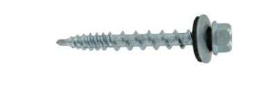

Here is an example of the screws I have been using through the v where the nail was.
Those screws do fine at attaching the steel to the steel with a self drilling head, but they are worthless for at attaching the steel to the wood. ;)

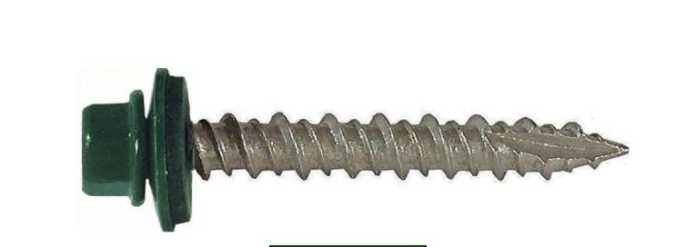

Just completed a total replacement in August, building is 50 x 120, 4/12 pitch.
For several years prior, steel drill point screws were replaced. The issue was that since the drill point screws are inappropriate for wood purlin attachment, they allowed water seepage to contact the wood.
The lumber in the area around the failed screw rotted, and a significant amount of purlin replacement was necessary during the replacement process. The deterioration was only visible from top side of purlin, impossible to inspect/detect w/o panel removal.
The new screws profile was rather unique. It still has a drill point, (tek, not needle) point but the body thread diameter was larger, with wood screw spirals. I
If the screw body is the same diameter as the drill tip, the holding power of the screw in wood is defeated. When we do replacements where an architect/engineer is involved, measured pull-out testing is required.

This is off of the Tek company site.
Tek® screws, which are self-tapping fasteners, have a very small carving at the end of its tip called a drill bit. This particular product is very popular since it is basically a self drilling product cutting back on the number of steps necessary to complete projects by eliminating the need to pre-drill.hese screws are meant for metal to metal applications only with the exception of the reamer tek® screw which is designed exclusively for a WOOD to METAL application.
Standard self-drilling tek® screws were never designed to go from metal to wood as the diameter of the hole that the drill bit will create will be close to the same diameter as the outside threads of the threaded portion of the fastener and will not allow the threads to tap into the wood to be secure. ***8203;The exception to this are some self-drilling screws that are manufactured for roofing applications. The drill bit on those screws is very tiny, a #1 drill bit, and the diameter of the hole that the drill bit makes is substantially smaller than the diameter of the outside threads of the rest of the screw. This allows the threads to really bite into the material and allow the screws to self-tap into the metal or wood for a secure hold.***8203;Contractors use Tek® screws for screwing metal to metal and sometimes wood to metal. Depending on the thickness of the material you are drilling into, you have several drill points available, the longest being a Tek® 5, sometimes referred to as a 'beam buster'. These particular screws allow the user to fasten two pieces of material together without pre-drilling.
These are sheet metal to wood roofing screws, it is not a tek screw.

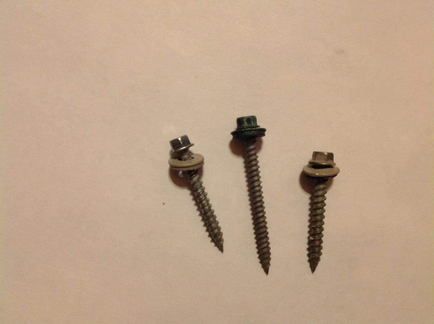

The ones i have been using I posted pics of have held well over last 10 years but I do like the pics of ones posted.

Well I finally got a chance to look for the screws I used which I bought right from the roofing place. Remembering back I did not predrill which would have made it easier I guess however the screws have such a sharp point (not self tapping) on them they went through with some pressure applied. After looking at the price I'll be going with a rust paint from a local home hardware and they will colour match.
