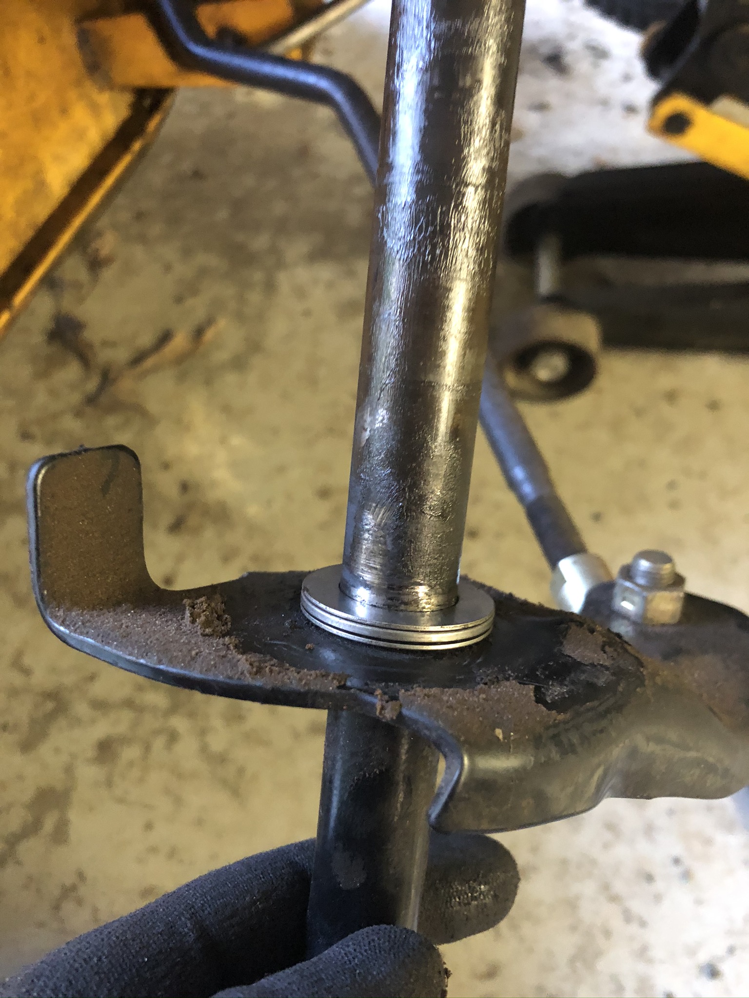

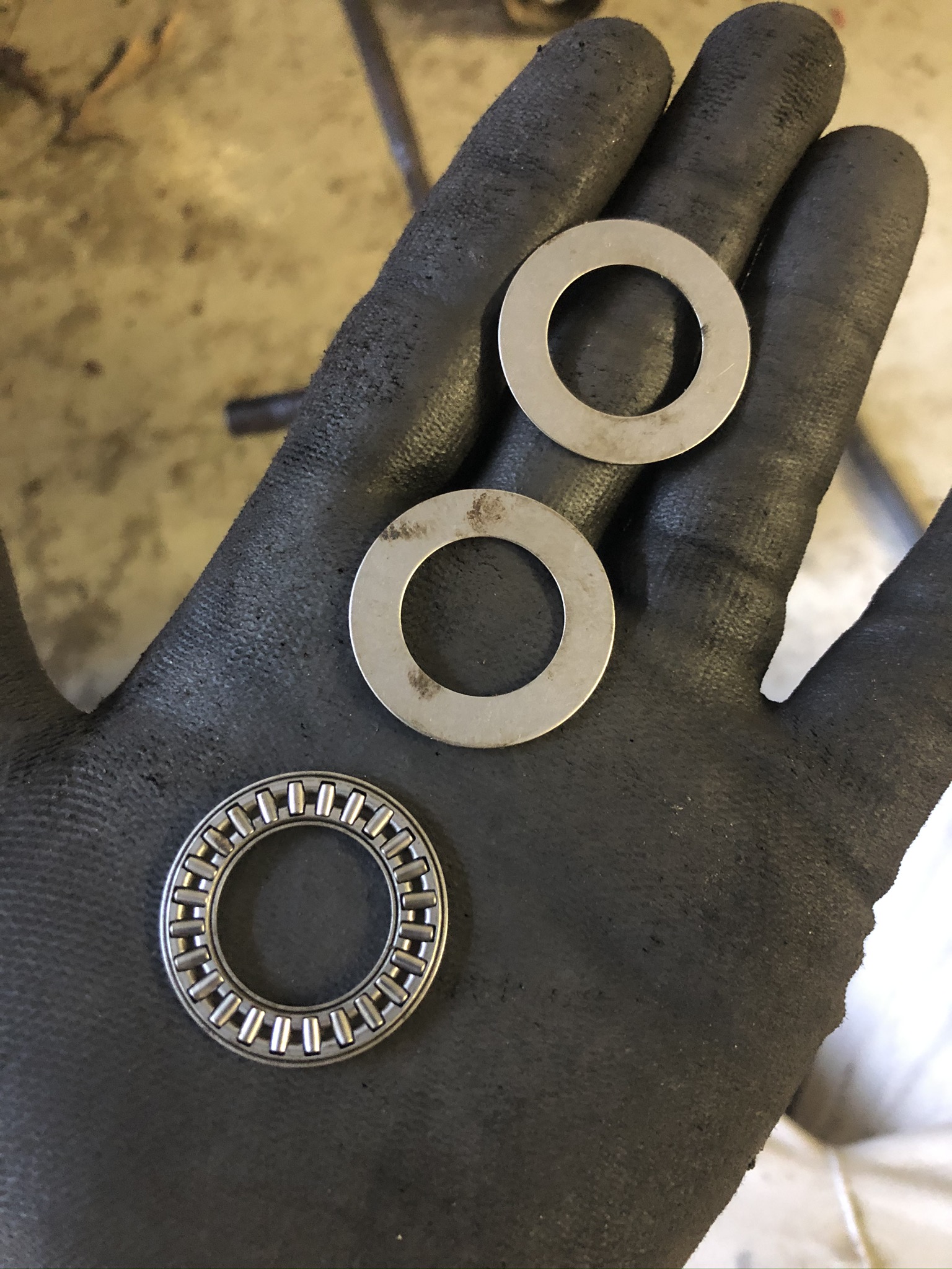

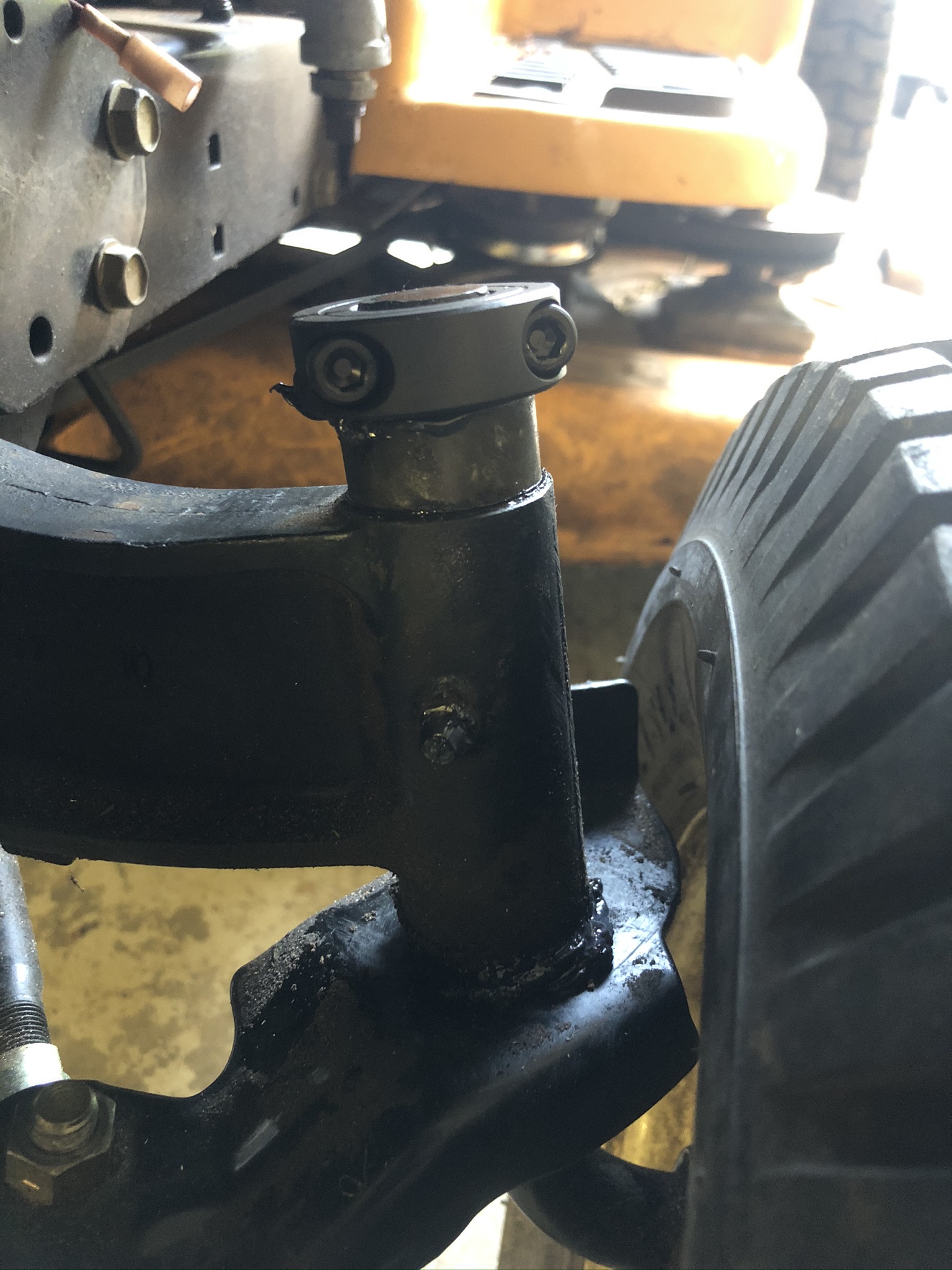

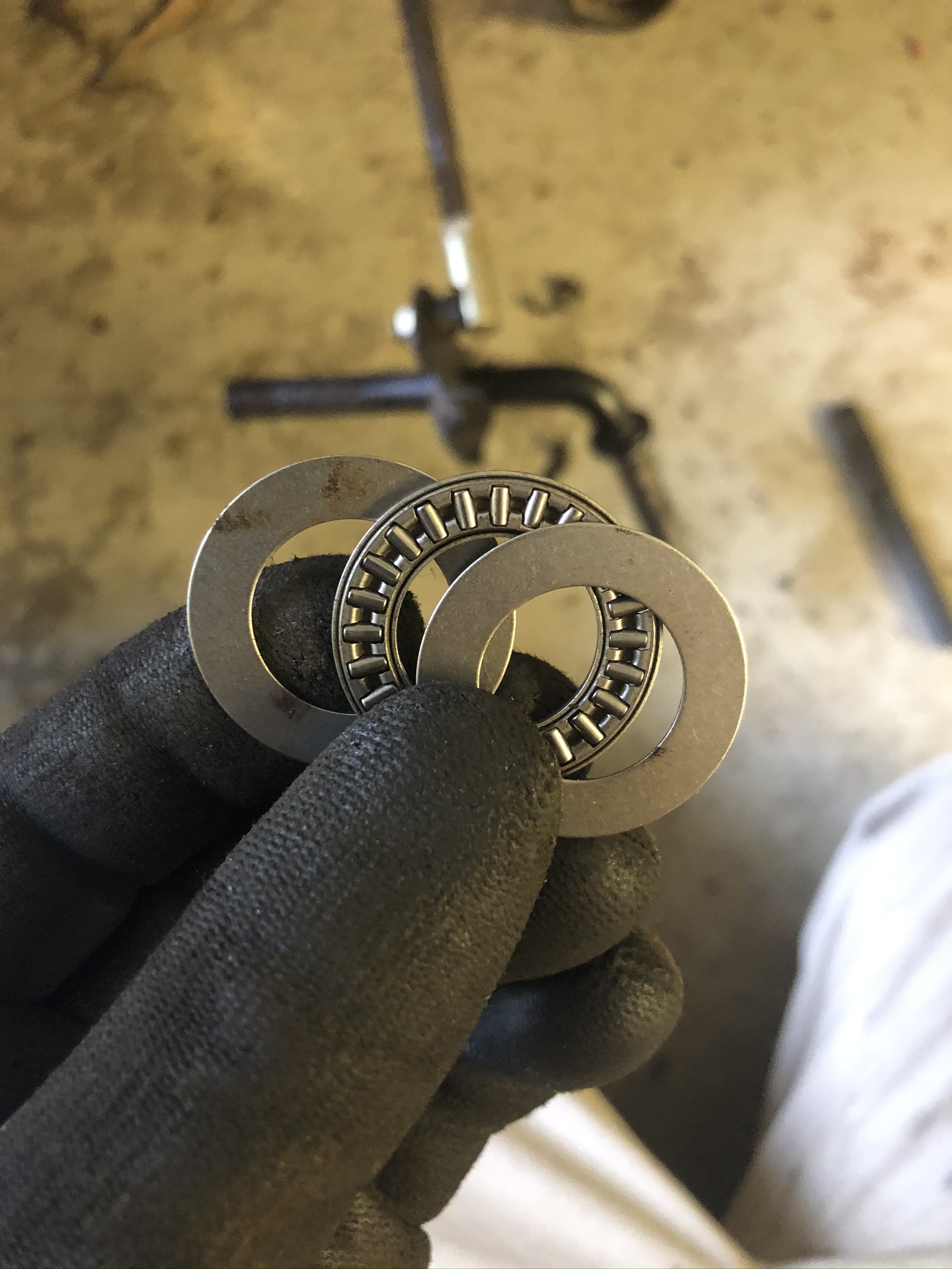

If you want that thing to steer with one finger, get some needle roller thrust bearings and machined washers. I did the same on my cub and it is awesome.
My setup is a bit different than yours, but should still work.

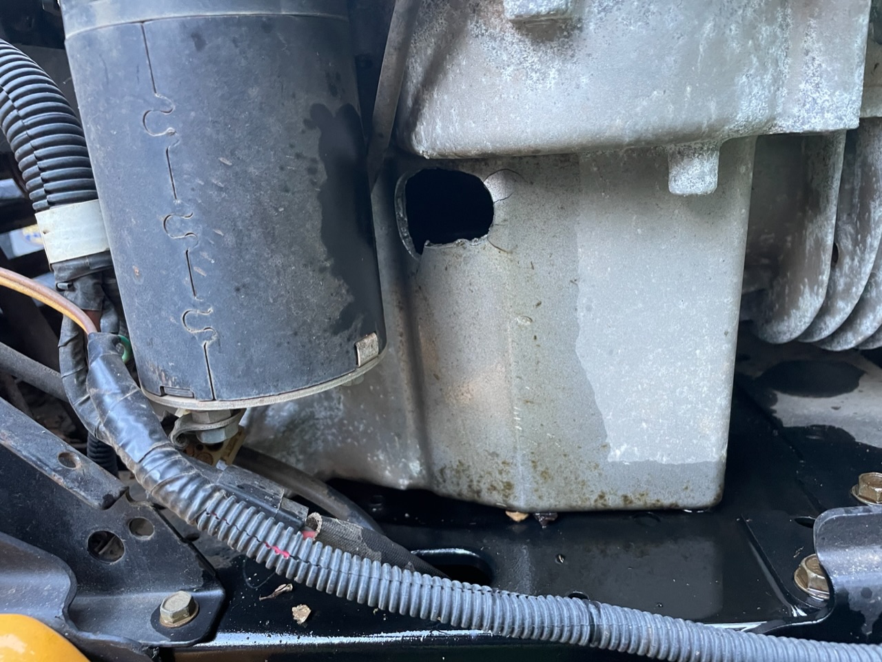

Also, that kohler 19 is a ticking time bomb. Pull the fan cover, and flywheel and lock tite a few bolts so they don’t wiggle loose, hitting flywheel and breaking the block.
Thanks Matt, Great idea for the steering! Simple, yet elegant, solutions are the best.
I will heed your advice and take care of those bolts asap.
So just pull the flywheel, and the bolts are right there?

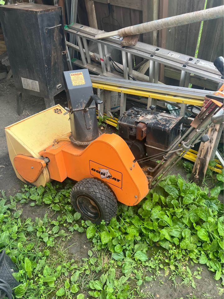

Sometimes folks just don't want it anymore! We just don't get enough snow to justify fixing or storing.
Free in MP.

Yes, fairly simple to see once flywheel is off. I tried googling, but my googlefu is apparently broken, as I can’t find anything on it. I “think” they are the bolts that hold the engine cover on.

Where does one find bearings like that? I've looked for some, but also didn't know what they were called so that probably interfered with finding them.

Ask for these: " needle roller thrust bearings ". Check at any industrial bearing supplier.

McMaster-Carr. I will warn you, that website is addictive and has literally everything.

those torrington bearings work good. I did it on a lot of the old Murray/MTD/Craftsman/Yard-Man/Deere/AYP mowers back when I bought/sold them. Makes em feel like they got power steering. Problem is on some of them you have to make modifications to get em in there as they're thicker than the original washer. Recently had a Husqvarna in, bought it for $50 at a yard sale, wouldn't pull itself. Dug the junk out from the clutch linkage underneath, cleaned everything up, tossed a couple torrington's on the kingpins and sold it for $700, and probably wasn't asking enough because it sold within 5 minutes. It cleaned up nice. Of course I serviced it up too. Have another YTH2448K out in the shop right now that needs the steering bushings replaced. I'm probably just going to make some rather than order em, then give it to my mom. She's mowing with a G1800, 2 wheel steer, she gets a lot of excercise sawing on the steering wheel. Before dad passed he overheated it so it's low compression on two cylinders and mom's limping it through the season. Winter project, I'm gonna have to rebuild it. Yay. Not looking forward to it.
