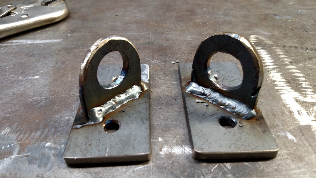

Terrible looking but functional tiedown bracket

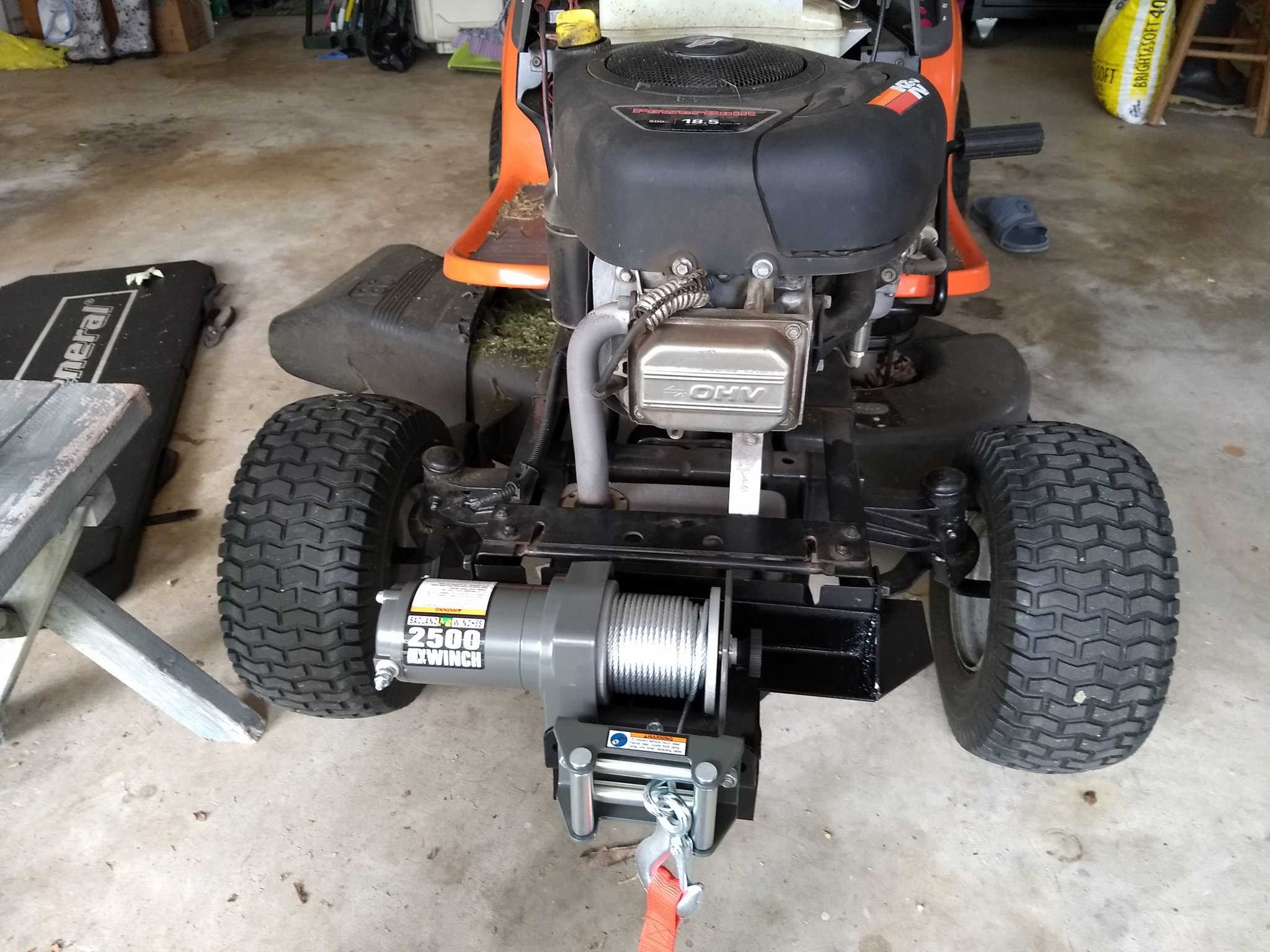

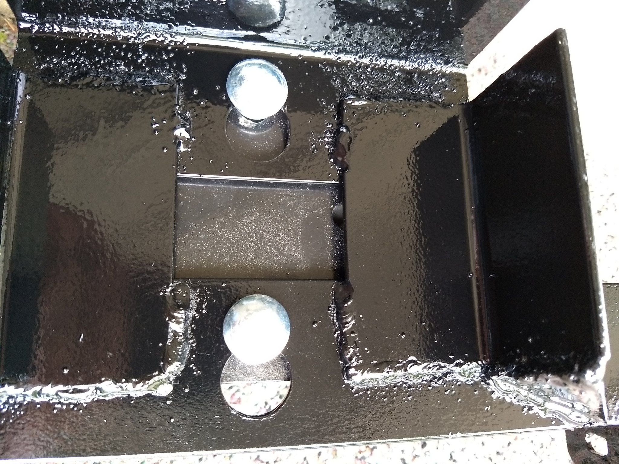

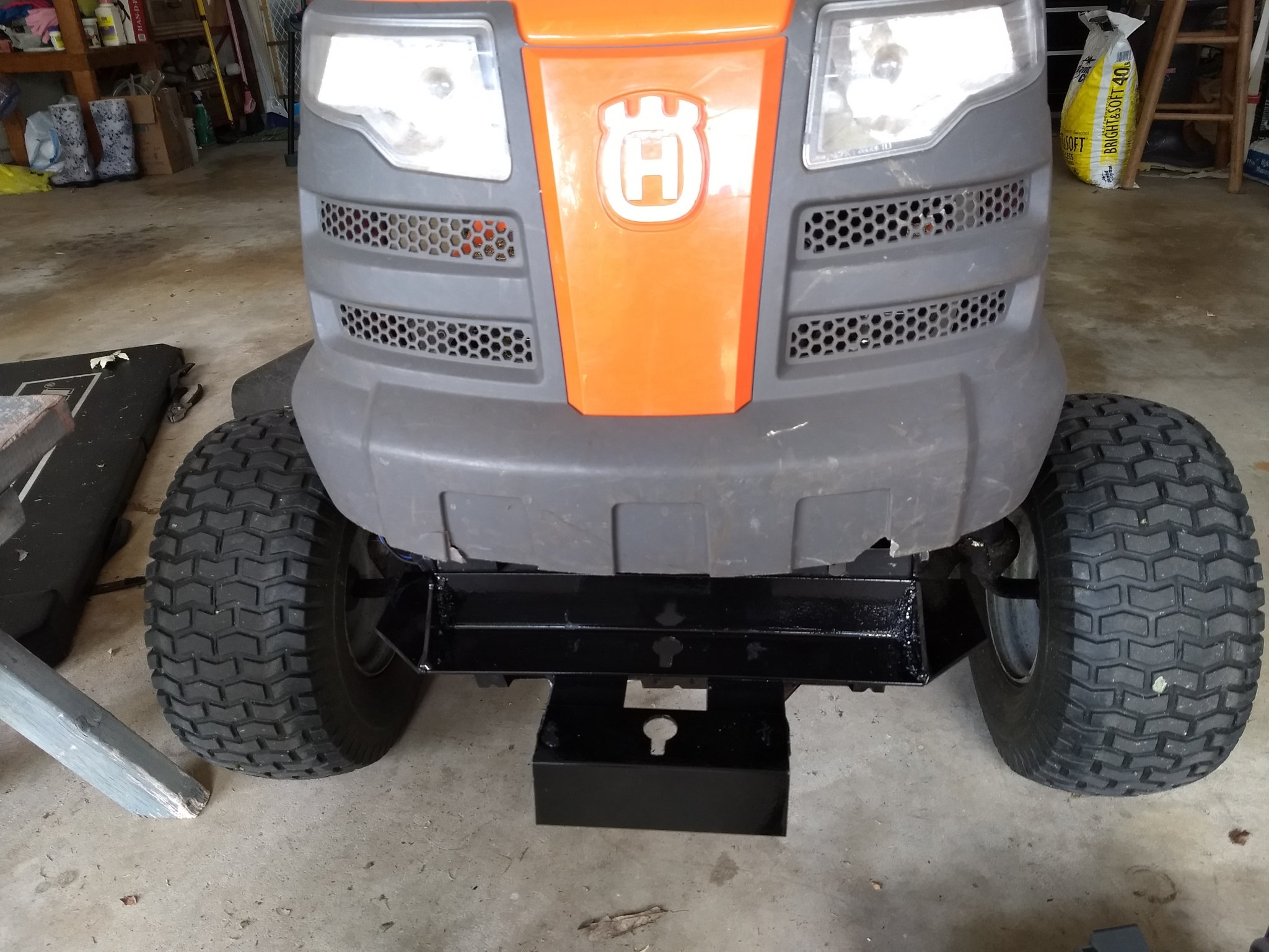

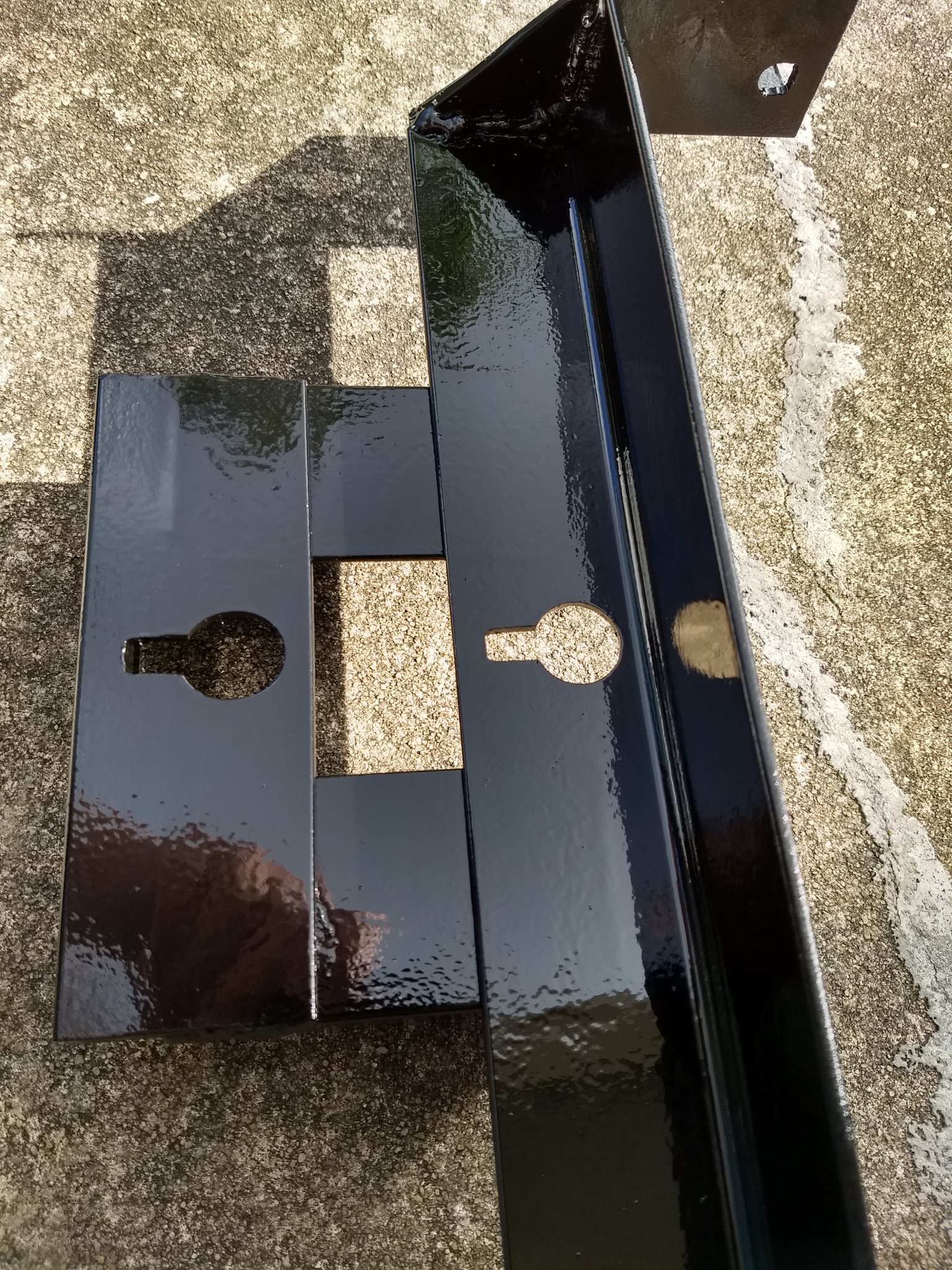

The last time I got creative like that was with my old Husqvarna. I was getting stuck all the time and decided to add a removable winch. So, I used two carriage bolts standing proud on the bottom of the winch and they would drop through the round holes on the bracket I made and as I pulled, the bolts would go into the square portion of the hole to be retained. The welding was not a big deal, finding the drill bit to drill those holes was the hard part. :ROFLMAO:
The BX is taking care of my "getting stuck" problems now.

That's a cool project. Can't say I've ever seen a mower with a winch before :)
Well done!

Dan, another source for some good beginners tricks and lessons is youtube videos. There's also some good online welding forums.
Nothing wrong with your first welds if they're structurally sound but wouldn't win a blue ribbon. An easy way to fix that before you paint: Mix up a little "JB Weld", clean your weld, and with your finger smear the mixture down the weld joint (just like caulking), let it harden, then paint. And no one will know that those aren't the best looking welds they've seen! :ROFLMAO:

That was not my idea. It seems that it is pretty common (local Craigslist and YouTube) to have an ATV winch on a lawn tractor. However I wanted it to be removable and not permanent. It came also handy when cutting down trees but I had to anchor the Husqvarna to the ground in order to pull. I have a similar setup on my BX but it was purchased that uses a standard 2x2 hitch receiver and the winch is pinned there. With the BX, no anchoring is needed. I was once cutting a 10 - 12 foot palm tree and pulling with the 3000lbs winch and I thought I had cut it but the winch had just pulled the thing out of the ground and the BX did not even move.

Dan, I was more referring to my personal experience than your welds. I've done stuff and thought "that was easy" until it breaks again and I find out my weld looked good but didn't penetrate like I had thought. The guys that are good at it make it look easy but it takes time and practice to do it "right". The practice is fun but materials get expensive. Enjoy the expensive hobby but don't get too good at it or else all your friends will expect you to fix everything.

I'm a new welder, teaching myself fcaw. Here is my second weld project, 1/2" D style tie down point for when hauling my BX2380. Had a tree (sweetgum) on far side of small creek fallover in recent heavy rain. Used the homemade mount point with chain to drag the trunk up the creekbank. I had to bump it a few times to get the trunk up the bank where I am now more able to cut it into firewood. The mount point was welded using multiple passes. The weld looks terrible but amazingly enough held up to the task of an anchor point on the chain.
There's an old saying " a grinder and paint make me the welder I ain't", or in other words, a bit of time with a grinder to clean up your welds and they would look as good as any. Well done on trying something new, and not just waiting for someone else to do it for you.

Those look nice, well done! I like the round design instead of D shape I did. I cut out the inside of D with jigsaw, haven't cut steel like this before so was a first for me. I did a lot of grinding with dremel to clean up the wobbly lines.
Yeah, I was concerned about penetration, another reason why I wanted to "stress test" it pulling the logs.
I've been watch many youtube videos, Tim Welds, weld.com, am fab and a few others. I learned about a few from responses here that I've been watching.
I am finding welding is like bowling, anyone can do it, but not everyone bowls a 300.
