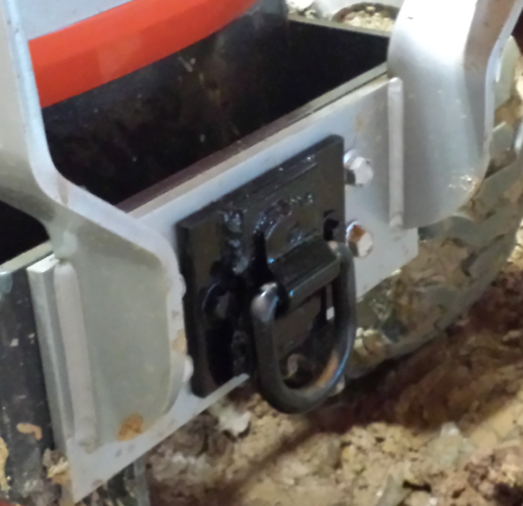

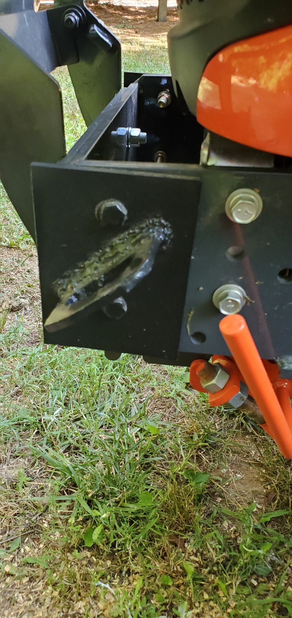

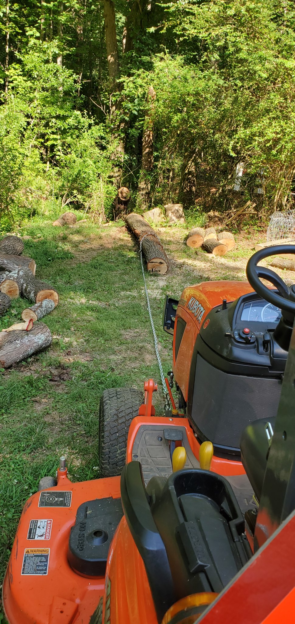

I'm a new welder, teaching myself fcaw. Here is my second weld project, 1/2" D style tie down point for when hauling my BX2380. Had a tree (sweetgum) on far side of small creek fallover in recent heavy rain. Used the homemade mount point with chain to drag the trunk up the creekbank. I had to bump it a few times to get the trunk up the bank where I am now more able to cut it into firewood. The mount point was welded using multiple passes. The weld looks terrible but amazingly enough held up to the task of an anchor point on the chain.

Not to bust you bubble - But a D-ring bolted would suffice - But I do understand a new skill and roll on!!!
Always better to pull from a center location when possible FWIW

A couple notes on "Why".
I made one for each side of the tractor as tiedowns for securing it to my trailer when transporting. I wanted to fab up something start to finish, that's why I opted not using weld-on D-ring. Plus, I thought the potential for the D-ring bouncing around would drive me crazy (I mow a large very bumpy field). Since I am learning welding (self taught), I saw an opportunity to fab up something "useful" and to practice my welding (and cutting/grinding) skills. In the past I've just hooked around the frame. I know the tie-downs worked for load securement, but thought this was the perfect opportunity to "stress test" my welds. A successful test and I'm pleased - only me 2nd project and thickest material I've welded to-date.
I get the "pulling from the center" position is technically the correct spot to pull from. But I'm curious....
Instead of doing like you mentioned.....you first welded the "bolt on" D ring to a small fish plate which was then welded to a larger fish plate which was then bolted through two larger steel plate framework on your tractor.
Couldn't you have just drilled two holes and used the bolt on D ring as intended by fastening it through your existing framework? It certainly would've been strong enough without the two extra spacer blocks between. The welds on the D ring bracket itself is the weak link in the setup?

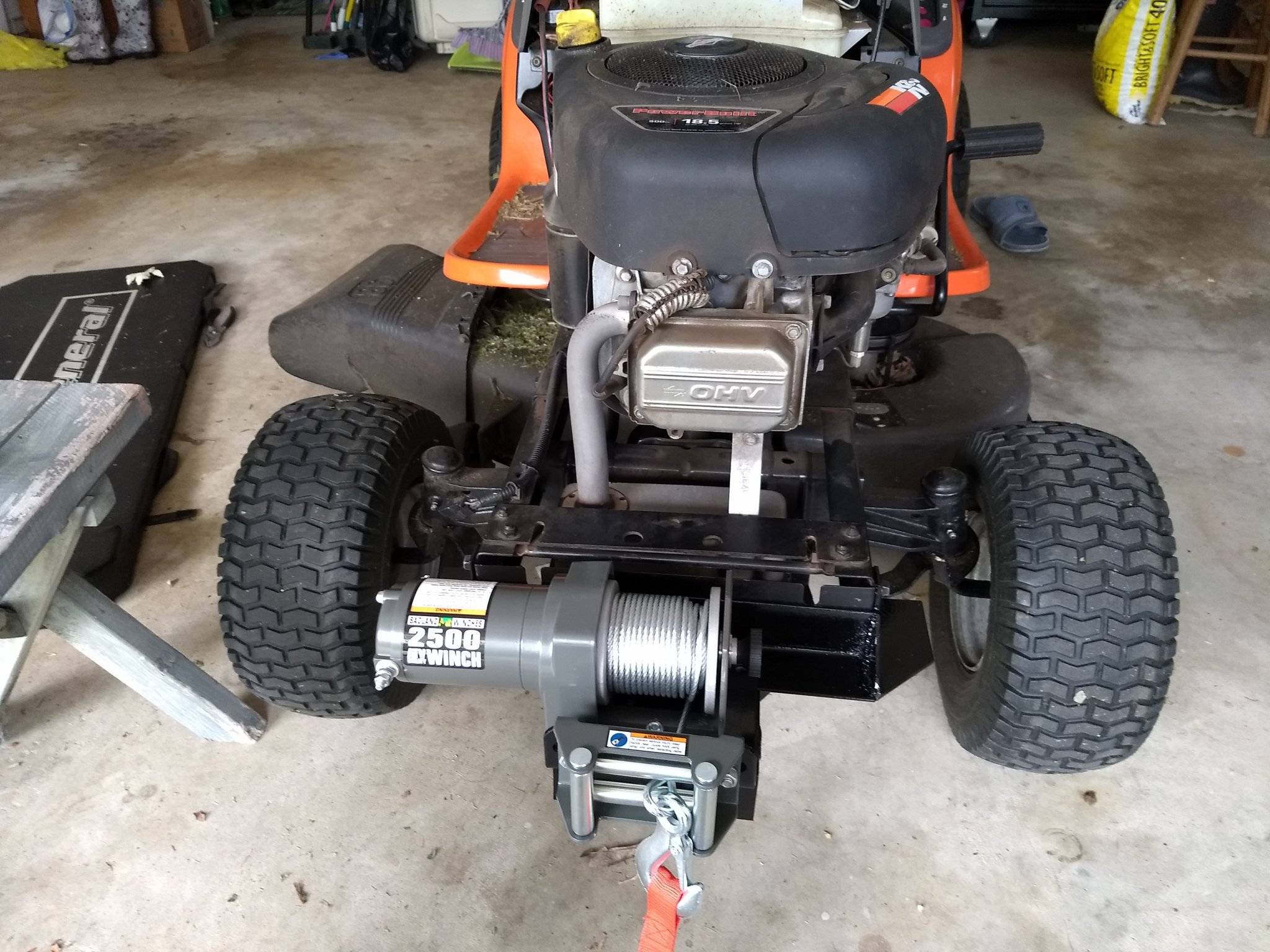

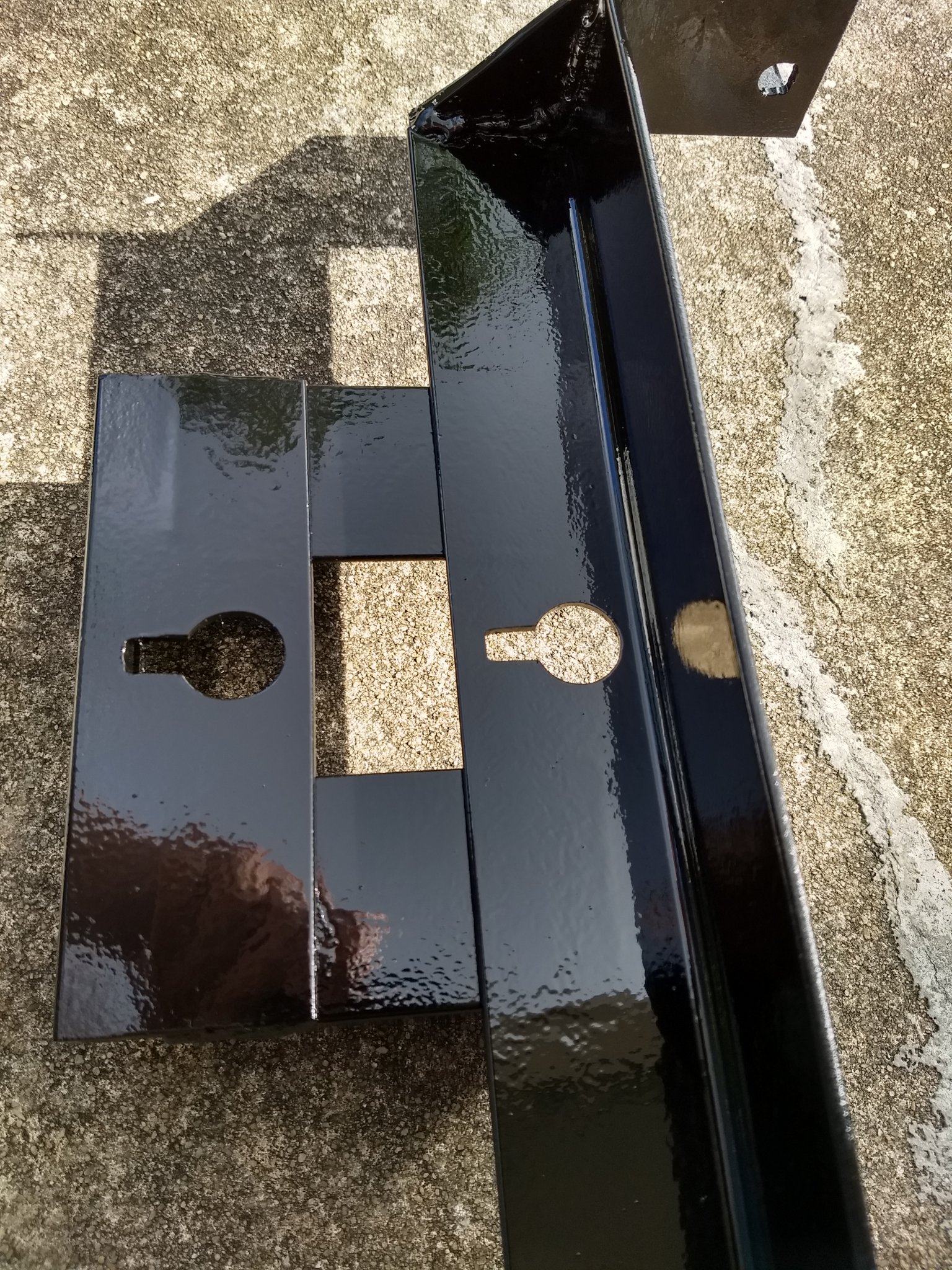

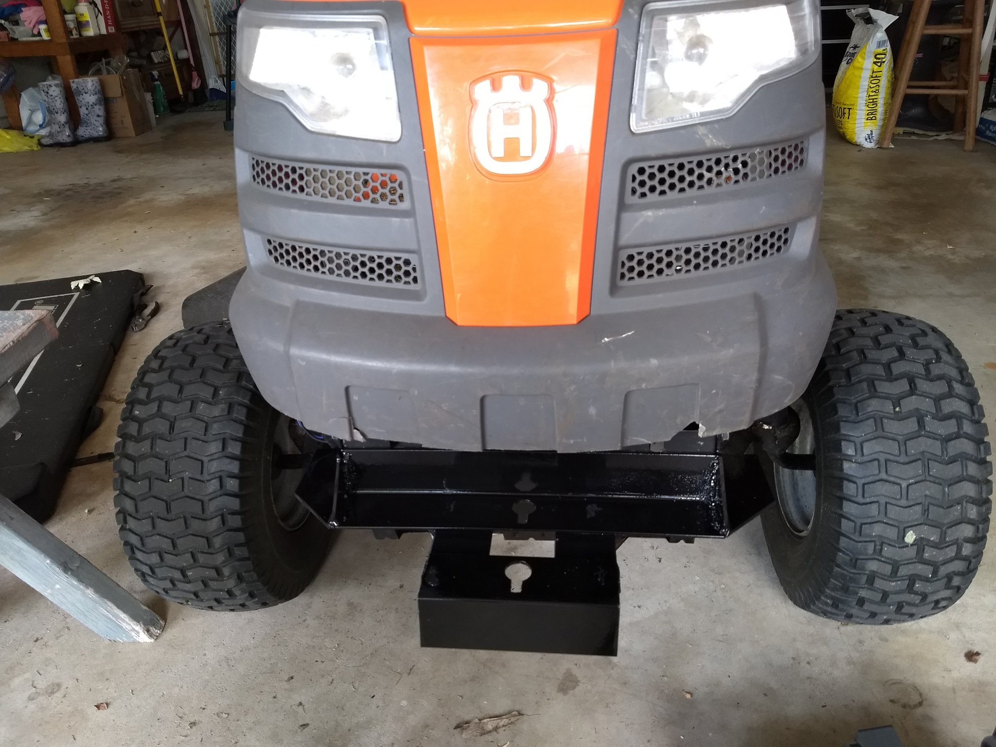

The last time I got creative like that was with my old Husqvarna. I was getting stuck all the time and decided to add a removable winch. So, I used two carriage bolts standing proud on the bottom of the winch and they would drop through the round holes on the bracket I made and as I pulled, the bolts would go into the square portion of the hole to be retained. The welding was not a big deal, finding the drill bit to drill those holes was the hard part. :ROFLMAO:
The BX is taking care of my "getting stuck" problems now.
