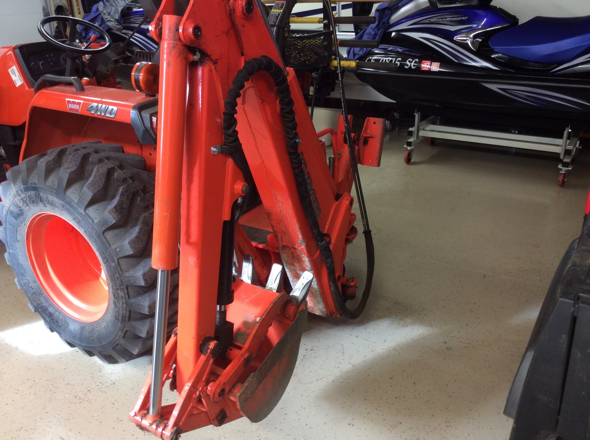

Here is one good reason (there are many!) to get them…rear remote operates the hydraulic thumb which is my most used favorite tool.
get them…
