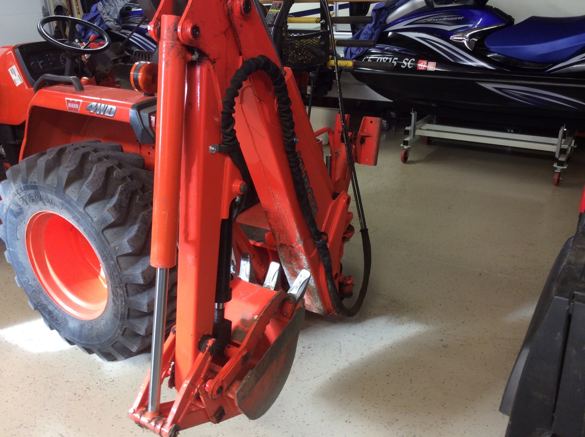

Here is one good reason (there are many!) to get them…rear remote operates the hydraulic thumb which is my most used favorite tool.

Any details on what cylinder you used for your thumb?

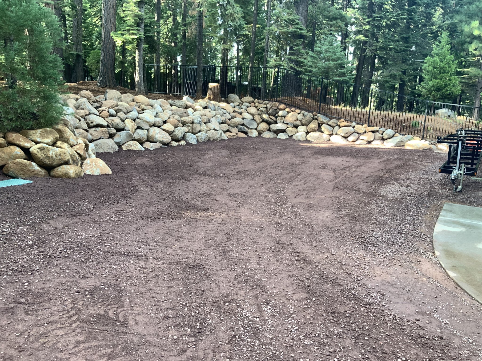

I really don’t. It is a generic ram that I sized based on the throw I was looking for. I had the manual type when I got it 12 years ago and grew tired of constantly getting off the BH to adjust it. I think I paid about 200 bucks for it and then plumbed the lines…no issues and it works great. When you have lots and lots of rocks…it is a must have…built several walls with it.
