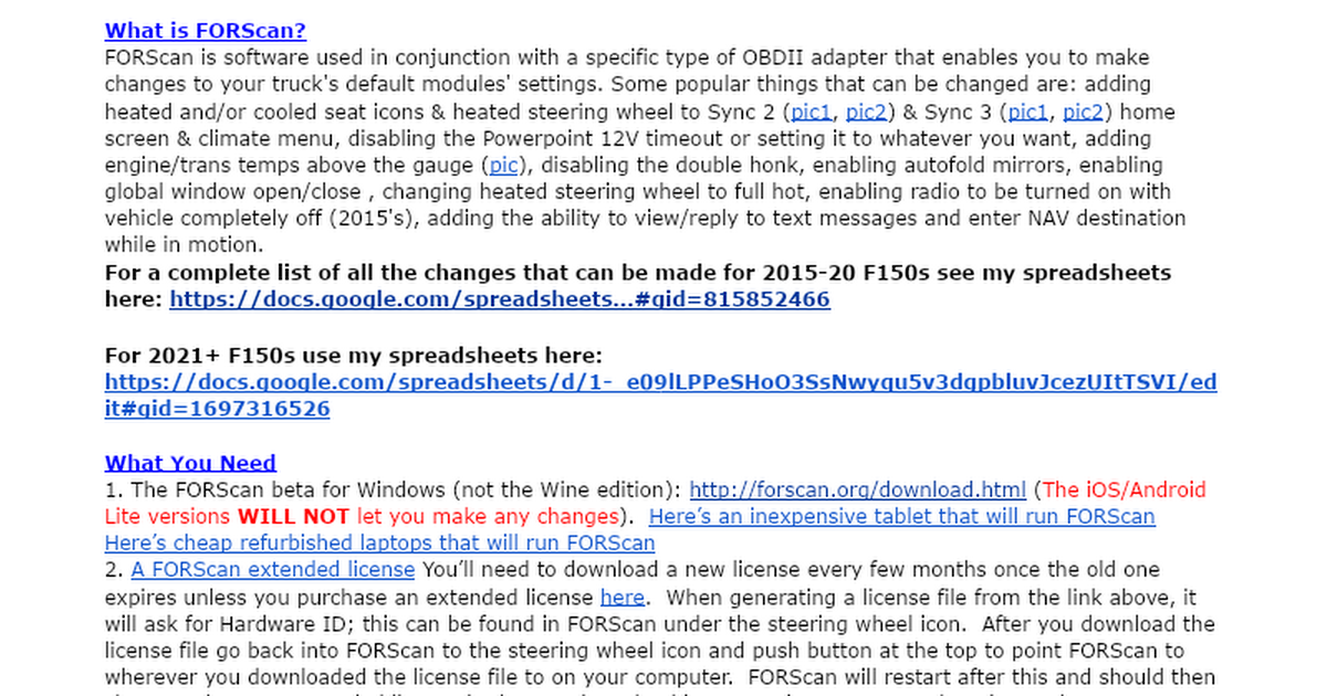

Should i or could i use Forscan to fix/disable these things? Anyone else deal with this?
I know Forscan can get rid of the door chime, among other things. Not sure on the airbag light. Try checking the superduty forum, https://www.ford-trucks.com/forums/forum5/

IM looking into cost of forscan. Might be worth it just to disable the door chime
The Forscan software itself is free. But I bought this needed tool off Amazon to ‘send’ my changes I wanted to make to my 2020 F250.
