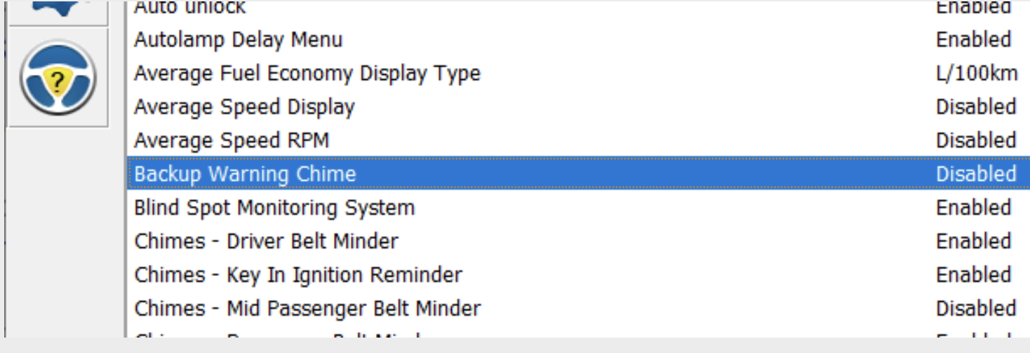

according to the links to forscan everyone has posted, the 2020 -22 spreadsheet DOES NOT list backup chimes as disableable. https://docs.google.com/spreadsheet...qiywd4-oWZg4aoYfGLCMTTO5Y/edit#gid=1226233122
Is that pic above for a different gen truck? Have you disabled the reverse chime in a 2020 superduty?

my '21 does not have reverse chimes, but all the other chimes have been turned off.
the guy who turned it off on his 2020 SD even made a video about it lol

link to video so i can see how its done. The ford and forscan forums dont show it being availible for a '20

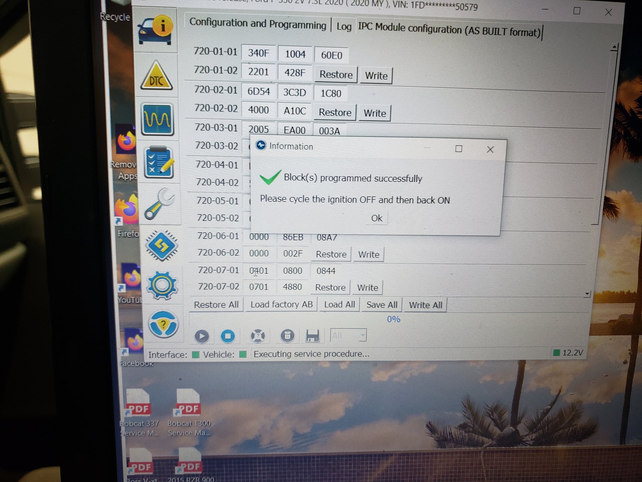

Got Forscan up and running and I was able to shut off all the chimes. No more dings with key in ignition thank god. Forscan offered no way to deal with the seatbelt issue (from original post), but the error code that was stored said the code was triggered by an open circuit.
While i was in there modifying the "as built data" I went ahead and enabled the twin turbo (adds 1000hp) and enabled high fuel efficiency, (99mpg)
So anyway, ford not so bad, Dodge/chevy sucks
