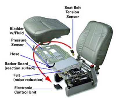

Couldn't find anything about the rear seats, but there are 2 sensors for each front seat: seat pressure and seat belt tension.

The dealer monkeys have no way to program the system to ignore rear seat belts.
Did you remove just the buckles, or the retractors too?
You won’t be able to just jump the two pins on the buckle , light will still be on, they use a Hall effect switch for the buckle sensors.
No weight sensors in the rear seats.
I don’t see the key in chime as programmable either on our side, Forscan possibly, but I can’t say for sure.
