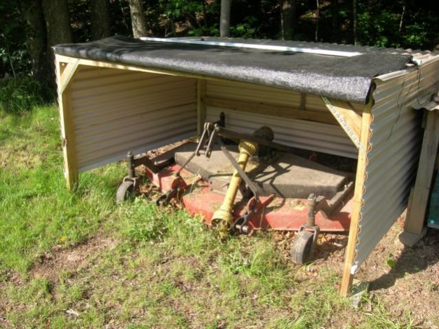

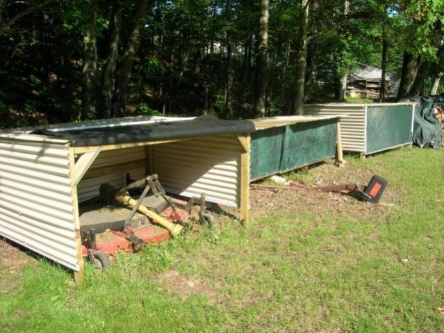

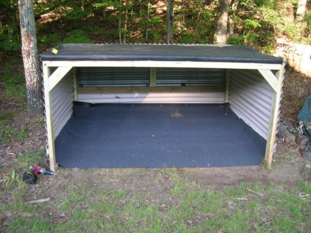

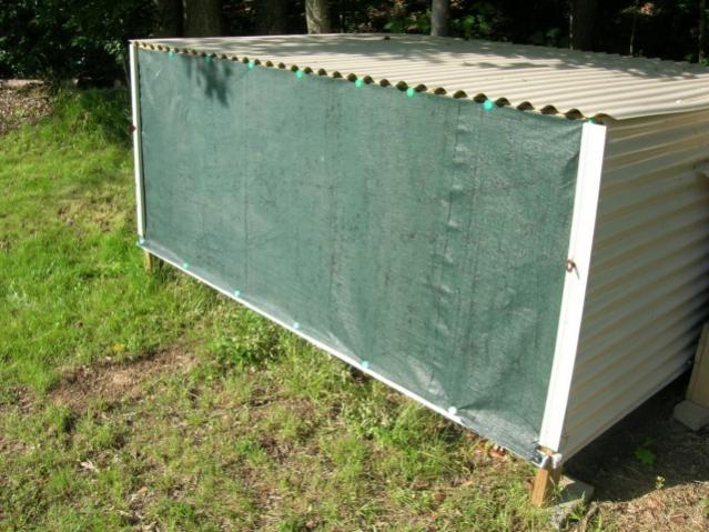

Most of us don't have enough space,(100 by 100 barn) to store the tractor and all the impliments. These are some pictures of what I built to cover the finish mower, tow dolly and bush hog.
It's just a 2x4 frame covered with plastic roof sheets. The front just folds up for a quick back the tractor hook up. There are steel angle iron bars driven into the ground at each corner to hold the box down from wind.
