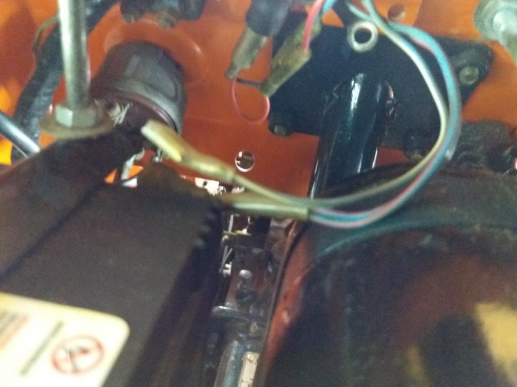

Have a small problem - well quite a large one really - with a B7001D acquired a couple of months ago with a flail mower to cut my paddocks. It had been working well, starting on first turn of the key and generally doing its' job well. Last weekend I used it for two hours cutting and put it away in a shed - all was well. Until I tried to start it again a couple of days later. Turn the key, oil pressure light up as normal, key to warm glow plugs and glow plugs warmed fine - turned to far right to engage starter and - zilch. Not even a flutter from the started solenoid. Lights working OK, indicators working OK, in fact all OK except apparently the connection to the starter motor solenoid.
Open bonnet (sorry, that's hood to you I believe as I'm on the other side of the pond :) ) and I find three disconnected wires laying there on the back of the panel. Honestly. Can only think that something vibrated free when I last used the tractor which didn't affect the running, but sure affected the starting. Two cables with female spade connectors one Blue and White and the other Red/Blue. Plus what looks like an Earth connector and a bolt hole that looks recently used. Now whilst I can find a bolt and put that back in place, I have no idea where the Blue/White and Red/Blue wires (which come out of the main loom bundle) connect to, as there no obvious place that they've come from.
I've attached a couple of pictures. If you have a B7001 could I ask that you have a look for me and let me know where these go please? Many thanks for your help.

Forget about the loose wires they are optional add on connection, for flashers, directional signals, and horn.

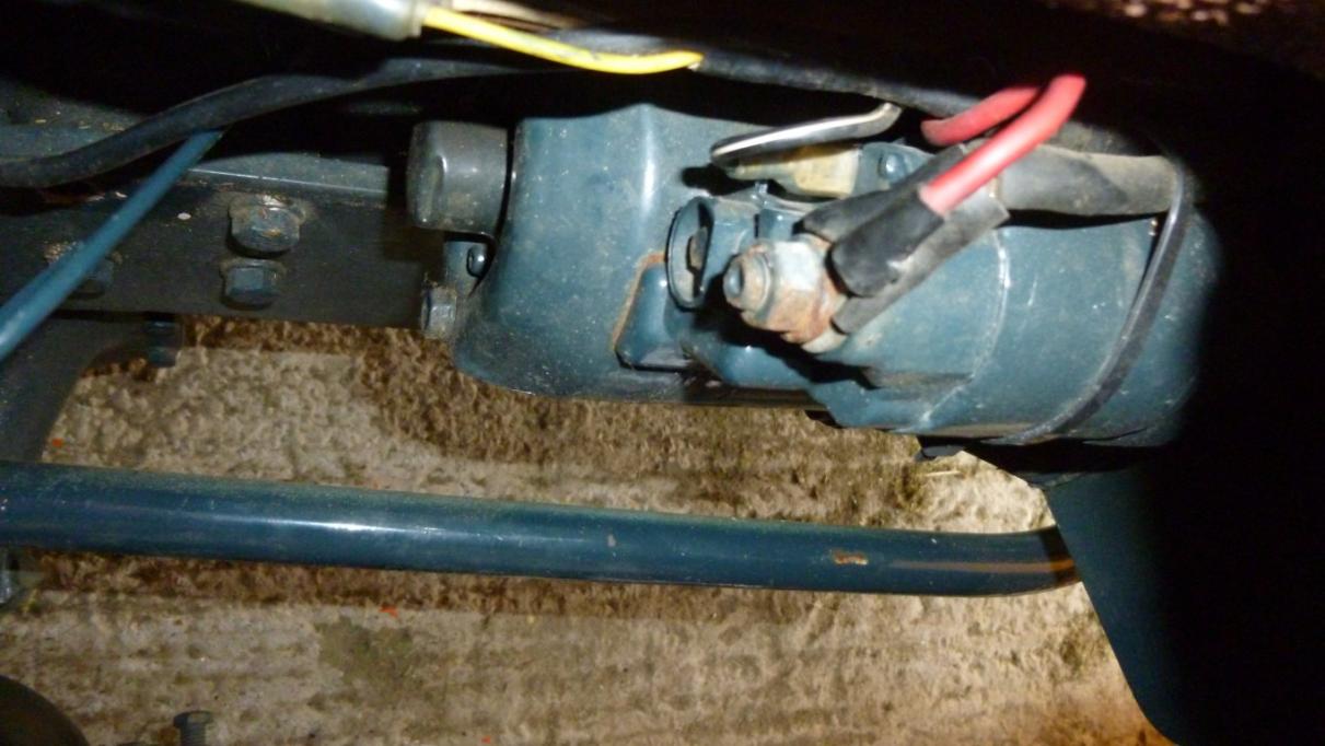

Well, further tests indicate that it's the starter motor that is at the root cause of this. Jumping direct off the battery, as suggested earlier, produced no response, but checks that full voltage was flowing down the solenoid trigger wire when the crank switch was closed were good. Battery is showing 12.77volts.
So new starter motor being couriered down to me for fitting next week. Being an absolute beginner (but learning fast!) my understanding is that this involves taking off the wires, undoing two mounting bolts at the back end, pulling off the old unit; then fitting the replacement by doing the same in reverse. Is this about right and anything to watch out for/hints and tips? Thanks.

JUST make sure you take your battery connections off first! I know - sounds simple, but I have seen many a person take a starter off while the battery is "hot" and turning that wrench creates a spark show if not extremely careful !:D:)

Since you mentioned "an absolute beginner" another tip on removing the battery wires.
Remove the negative wire first. That way if your wrench touches another part of metal there will be so spark. If you remove the positive terminal first and your wrench touches some metal, you get a spark! When reinstalling put the negative on last.
Also, since you have the starter removed, take some emery paper and clean the surface area the starter bolts up to. There will probably be so light rust, etc there. This assures you get a good ground at the starter.

Thanks for all your help and advice on this one. The seller sent me a reconditioned Starter motor/solenoid assembly. I tested this and then fitted - and having rehearsed it well the fitting was even more straightforward than I could ever have imagined. Just rather glad that I still have a full socket set with extension bars to reach the mounting bolts.
Removed the old unit and found that the gears that engage with the flywheel (Bendix?) were jamming in the extended position. Fitted the recon unit and all is well.
