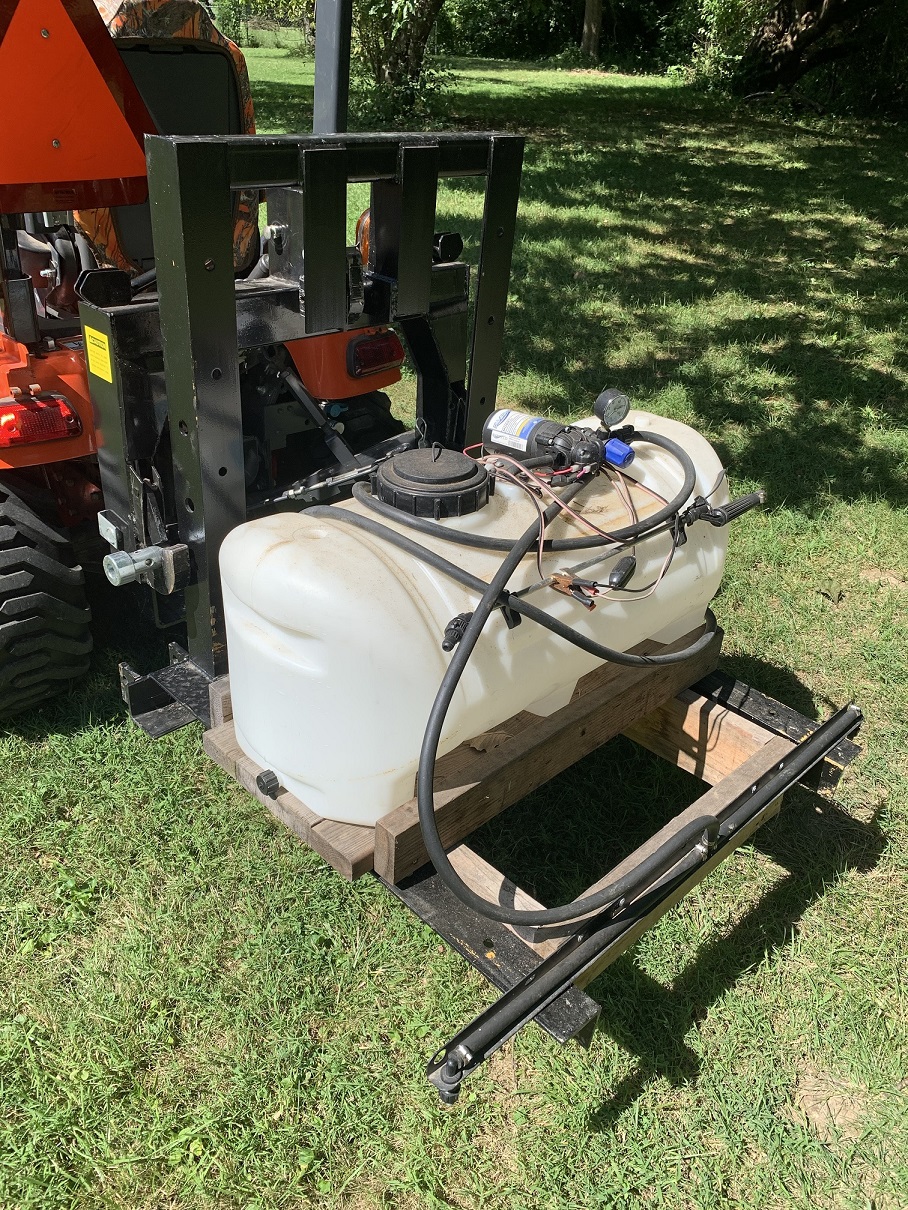

I adapted my Country Line carry all to be quick hitch compatible and use a 15 or 25gal (can't remember) sprayer mounted on a wooden pedestal. I just back up under the sprayer with the carry all and connnect power. If you want a picture, i can send but, won't be home for another week.

Ping, exactly what I was thinking about doing. No rush but would appreciate a picture and info about what had to be modified to the County Line Carry All to fit the quick hitch. That's the one I was looking at. Thanks!

Glad to help, I'll post some pics of how I've got mine set up. Probably won't be until Tuesday next week though.

I modified my TSC carry all to be compatible with my RK quick hitch. Moved the lower pins closer to the tractor along with the top mount. I also, lowered the bottom pins so i could get a little more lift when on the back of the tractor. Also, added some details down near the bottom which allow me to mount on the loader end. 25gallon sprayer mounted on 2x6 box with 2x4 deck. Power runs back to the battery terminals with switch next to 3pt lever. Tie down straps (not shown) to hold everything in place is gravity decides to take the day off. The reason I moved my attachment points closer to the tractor is I plan to build a box for the carryall whenever I get caught up on Her Majesty's list. Let me know if you have any questions.
