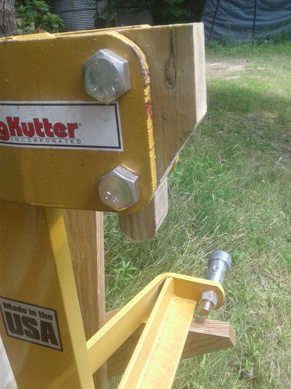

King Kutter makes a 4'XB tiller - must be a sub cat 1. Purchased longer implement pins and spacing washers. The top link bushing was in the rear hole, moved to front and used bolts for rear supports.

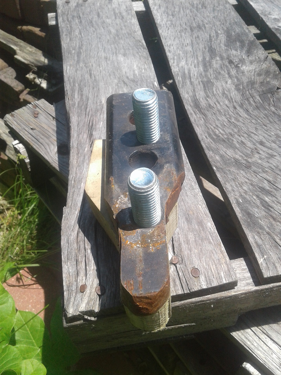

Moving on to ballast box. I purchased a Titan box off Amazon. The top link hole was not in the same vertical plane as the lift pin holes and it was set too high. I used a QH top link adaptor in a unique way. Drilled new holes for top link pin.

Let's up the mod game and fix RK/King Kutter subsoiler and middle buster. In the photo below you will see I run the top hook in the lowest holes. The easy fixs to raise the top hook by two holes - then everything else doesn't fit. First thing to do is create an adapter pattern. Trace the shape of the hook, attach implement and drill it's top link pin holes.

Might as well mod the old junker King Kutter rake. The top center support was in the way. Cut it loose, used 4ton porta-power to jack it up out of the way. Drilled some holes then had a change of plans. Bought some flat stock drilled 3/4" holes for top mount an 3 1/4" holes through old top brace. Removed every other tine to turn it into rock/brush rake. Yep, it also needed a parking stand.

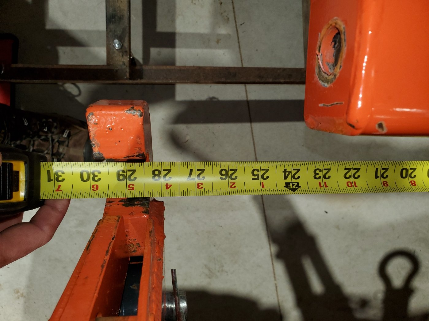

Hello. I'm faced with modifying a back blade which is too narrow on the bottom links to mate with my quick hitch. I took the bottom link pin out of the back blade pictured below with the idea that I would buy a new pin long enough to make up the distance. The longest pin that I could find was 6.5". I could make this work by drilling a new hole for the roll pin into the Cat1 to Cat3 bushing more towards the end of the bushing for the roll pin. That seems a bit dodgy though as the bushing wouldn't be all the way on the bottom link to get the width I need.
Any other suggestions?

Hardware or farm store may have 7/8" bolts that are longer. Go for grade 8 or 5
I thought about going that route, but the problem is most bolts aren't fully threaded in that length. In fact, I couldn't find one searching online last night.
put bushing on bolt, spacing washers, insert into implement and add lock washer and nut
