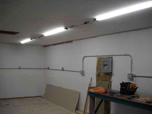

Got some inexpensive linkable LED shop lights from Amazon. Around $40 for a 4 pack. Like the light, like the mounting system (clips). Remains to be seen how long they last.
Gonna run a row down the other side of the shop. Running on an extension cord for now, need to install a switched outlet for each row of lights.

Jimmy, I did it that way because it's easier to modify if changes are needed down the road. Also, I don't have to worry about wiring in the wall being damaged when I hang shelves and such. Plus, it makes insulation much easier to do and more efficient as you don't have to work around wiring and boxes.
Houses are wired through the walls for aesthetics - most industrial wiring is done in conduit.
I put wiring in a couple walls in my shop. I have now decided to finish out the other walls and put the wiring on the surface in conduit like you have done for the same reasons you mentioned. Live and learn!
After all it is a SHOP! Function over form in many areas!

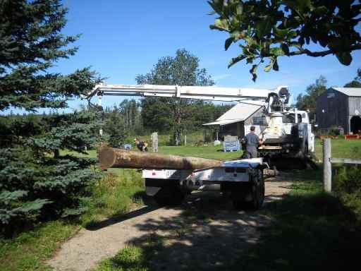

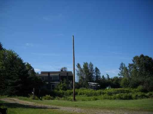

After flip-flopping around for weeks trying to get the power company to work with me, I finally decided on a plan for running power to the building. One major hang-up was getting someone to set a pole, but I finally managed that:
Took about half an hour with the right toys. I may have the only property in coastal Maine where you can drive a post hole digger out of sight without hitting ledge. The "inspector" blessed the plan and scheduled the hookup. Hoping that will happen by the end of this week.

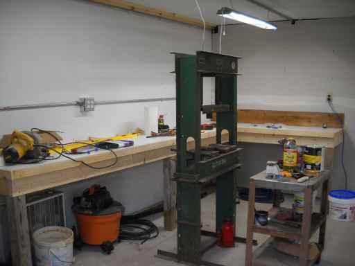

Hung the last of the drywall, got the ceiling trim mostly done, built a bench along the South and West walls.
I may live to regret my choice of materials for the bench. Framed up with 2x6, screwed to the wall studs and 4x4 legs on the outboard end...all of which is fine. Framing topped with 1/2 CDX which is...okay. Normally I'd use 3/4 but the price is just stupid.
The real questionable part is that I used 3/4 inch melanine-sheathed particle board for the finish top. Suspect that may come back to bite me in the butt. Again, decision driven by price - A/C plywood (my usual go-to) is over $100 a sheet! Worst comes to worst, I'll either take it off (it's just screwed on from underneath) and replace it when (if...) prices come down, or cover it with some black iron sheet (if the price is any kind of reasonable at all).

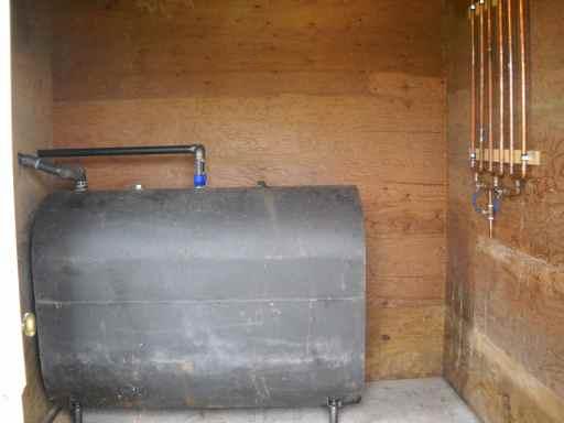

The "chicken coop" got cleaned out good, pressure-washed, disinfected/de-odorized and the 275 gallon fuel oil tank is in place and plumbed up. Power has been run for the air compressor and eventual furnace. My furnace guy is looking for a suitable trailer or cottage base hot air unit.

Still piddling around with little stuff while I wait for the power company to hook me up. Finally (after 3 weeks of asking) got a window when I can expect that to happen: 8/25 to 9/14. Sigh.
The above is a shot of the "chicken coop" end of the building with the oil tank installed and plumbed and the air dryer loop mounted to the wall. The compressor will go on the left side of that picture with a riser up the left wall and across the ceiling to the air dryer. There'll be an extra drain leg on the riser at the compressor and the compressor will be attached via a flexible braided hose to cut down on vibration.

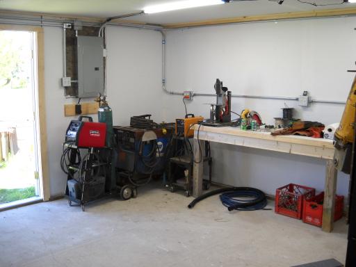

Hit it at 5:30 this morning. Wired up the welder outlet, moved two welders and plasma cutter into their new home.
Also moved and set up the 2x72 belt grinder, the porta-band with it's stand, the drill press with cross-feed table and vise, and adapted a HEAVY metal table for the bench grinder.
Moved the big tool box and the shelf/drawer unit and all contents.
Also moved a couple of pallet loads of little stuff. The forks on the Cabota got a workout!

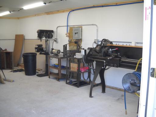

Grandson showed up on schedule and we moved the heavy stuff. The lathe was ALL the Kubota wanted to pick up. I didn't have room to hang anything off the back for a counterweight while maneuvering in the garage and as I transitioned from the garage floor to the driveway, I got daylight under the left rear. Once I got it outside and unclenched my cheeks enough to get out of the cab, I went down and put the mower on the back. MUCH happier that way.
The compressor was a bit of a beast to work with once we got it in it's space, but there's JUST enough clearance to close the door.
Picking the furnace up and setting on it's pedestal/plenum turned out to be pretty anti-climatic in comparison.
Now I just have to finish plumbing the air, wire up the motor starter for the compressor, wire the safeties for the furnace and run the duct work. Shop is usable as is except for the lack of air.
