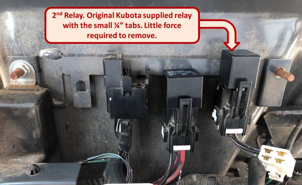

For what it is worth, relay #2 (not Glow Plug Relay) was replaced with the 80 Amp relay to prevent any potential issues with the poor terminal fit on the power side of relay.
The relay socket is the same type used on the glow plug circuit utilizing the larger 3/8" tabs. Didn't want to have the same issue of poor limited current carrying ability on this circuit. I'm not exactly certain the name of this circuit, but it does prevent the tractor from starting.
The stock 40 amp relay with 1/4" tabs was very easy to remove from the socket and was pleased at the increased force required to insert the 80 amp relay with 3/8" tabs. Hopefully increased force will correlate to better electrical continuity.
For the record I left the glow plug as is. It is starting with ease in low temperatures and I didn't want to go through the hassle of disassembling the socket again to remove the paper clip shims.
Pictures provided for reference.

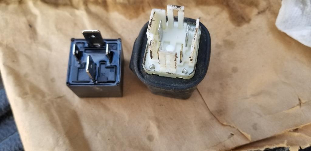

I ordered a pair of the relays and when I pulled the dash I discovered mine are different. I simple did some cleaning under there, unplugged some connections and re-installed them. My tractor is an L4240D, serial # 31241.
Here's a comparison of the two relays.
200mph
Mar 3, 2017
1,228
65
PA
I hope that relay never goes bad for you. It's one of the most expensive relays I've seen.
RELAY, GLOW - RELAY,GLOW
T1060-33710 $91.72 4 in stock 2
