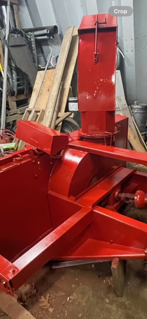

It's an easy mod with a 12 vdc actuator. Here is my setup on my 5 ft lorenz blower. See post #14
A simple 2 conductor supply cable to the actuator from a DPDT (spring return double pole double throw, center off) toggle switch or other will give you reverse direction (chute up or down) control.

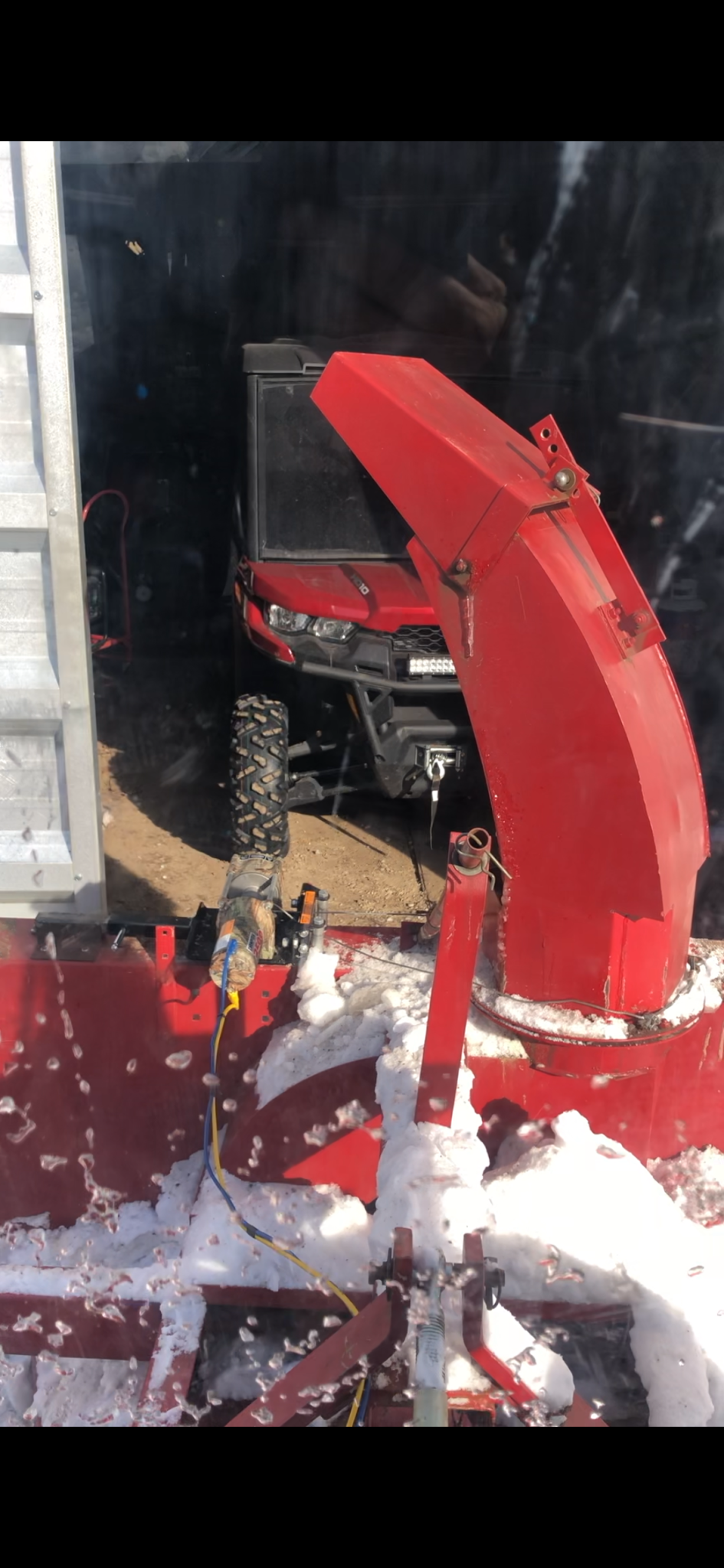

I used a winch to operate my chute rotation. Not the fastest rotation but it gets the job done with little thought process. lol not the best photo but I guess I didn’t take many during the quick conversion.
