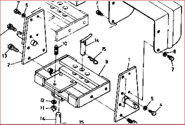

This is what your dealing with.
And this is what you need to fix it up. Give a shout if you can't find one locally, it would take a bit to send it to you but I have a bunch. ;)
