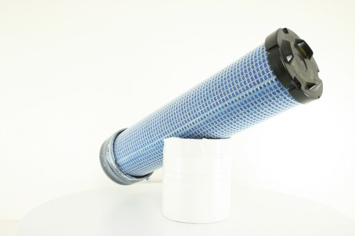

I have a new BX1880, 40 hours on it..Doing some research on air filter for it I ordered from Messicks the inner pre filter..
Kubota #3A111-19130 Inner Air Filter. This is the latest update p/n it fits inside the stock filter into the round hole inside the air box.. Nothing will get by it. Air only.
Looks like this,check Messick's for details and their service videos :
I was under the impression the BXs only have an outer filter. Is that the case and this is an optional inner filter?
Whatever’s going on with the OP’s tractor, as long as the filters are installed in the housing correctly, this should address it.
