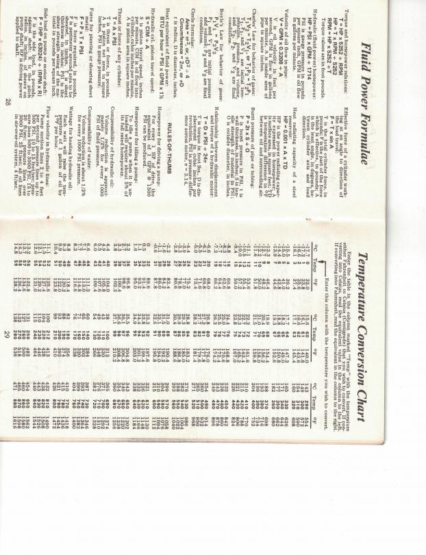

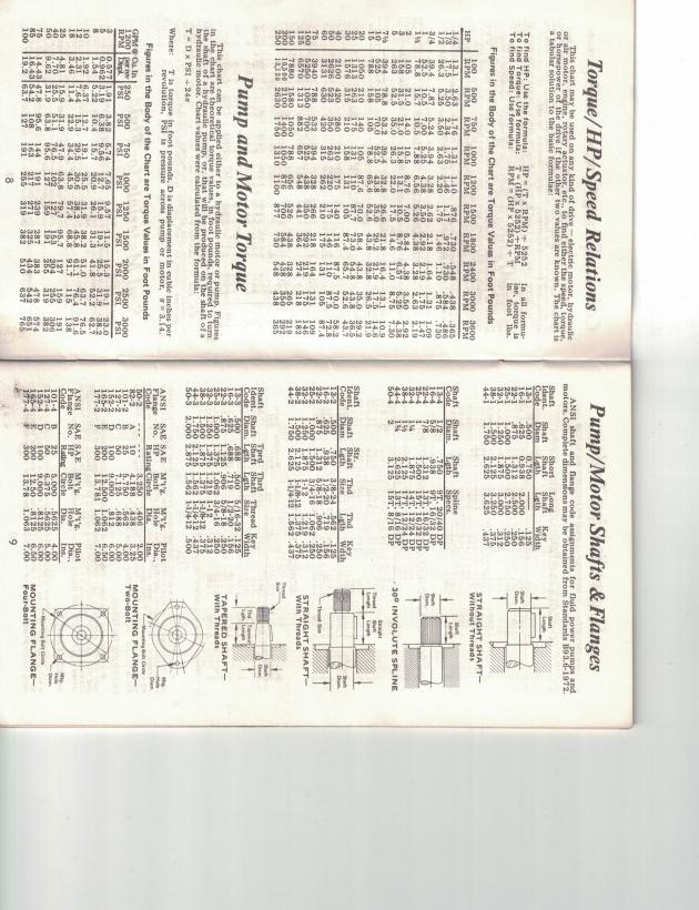

My tractor hydraulic system puts out 5 gpm at 2200 psi. I have researched and found a hydraulic motor for a capstan winch that will give me close to the 60 rpm I am wanting at 5 gpm flow. My question is, at what engine rpm are tractor hydraulics rated. In other words, I want the motor to run at 60 rpm when the tractor engine is at or just above idle not at or near max rpm. How do I figure this into the selection of the motor.
The motor that I found is 15.4 cu.in. motor. How do I know if this motor is sized right or if I need a smaller or bigger flow motor to get the rpm I want at or near idle.
Here is an older version of the online calculator along with some additional information that may be of use.
