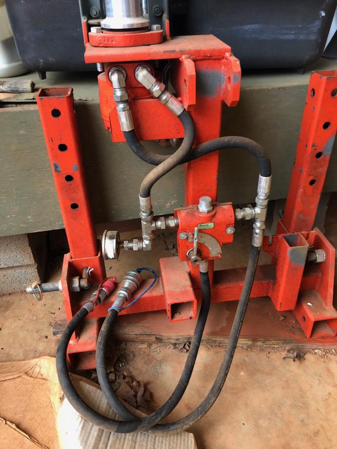

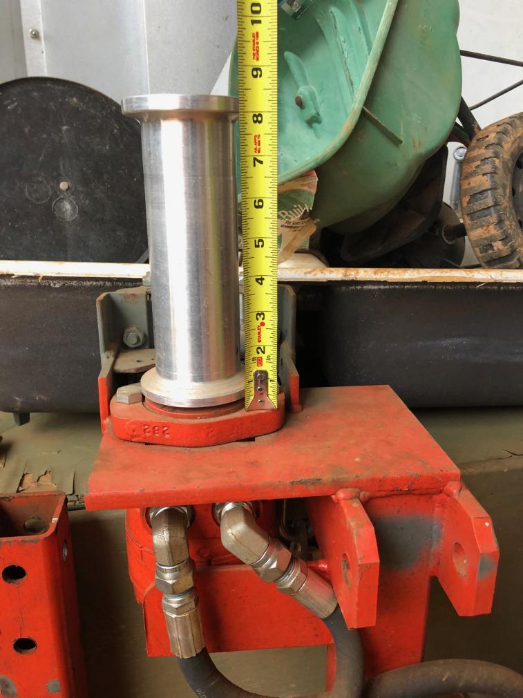

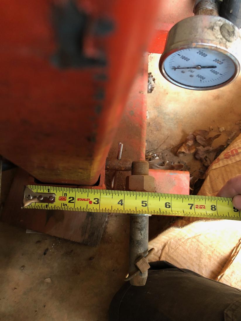

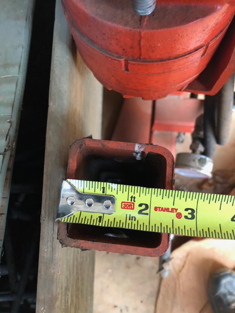

As requested, here's a few pics and dimensions.
The brace arms (not sure what they're properly called) are 2.5 x 2.5 x 1/8" square tube.
Outer sleeves for the brace arms are 3-1/8" x 3-1/8". I'm guessing that's 3" nominal, but I'm not sure.
I gave the plans to a welder friend who did all the steel cutting and welding for me so I let him pick the sizes. That same larger size square tube also fits a standard 2" hitch (center).
