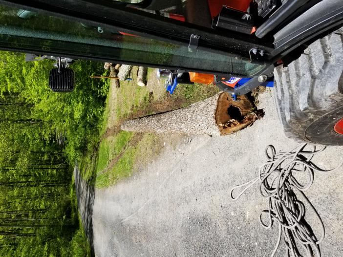

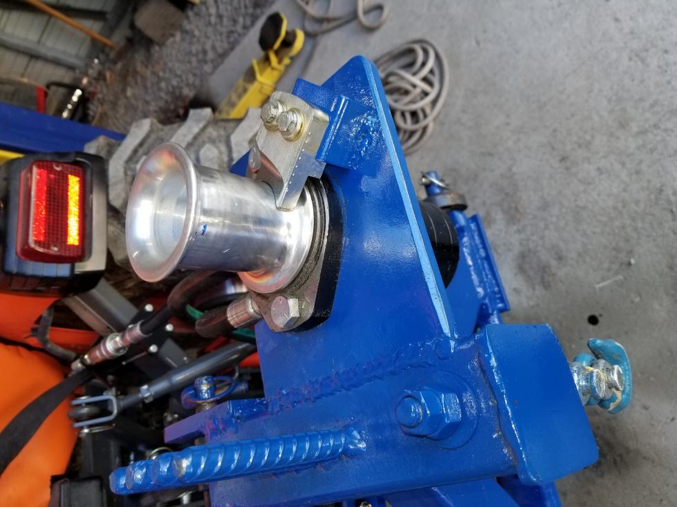

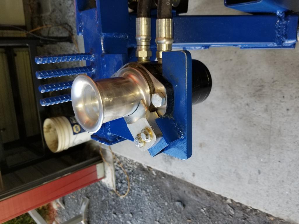

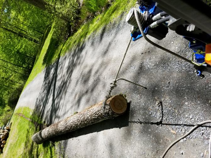

Got everything all plumbed in last night and gave it a try today. Only thing I have left to do is paint the drop legs that keep the tractor from being pulled backwards and build some permanent mount brackets for the hoses running back to the rear remotes. I was a bit skeptical because I very briefly tried it out last last night with a short piece of rope I had laying around and it was bunching up issues like Crmorse was having. Today I tried it with the actual rope I will be using and I pulled my 600 lbs concrete counter weight off the pallet and across the ground without any issues at idle. Needless to say Im pretty happy but more use will tell the whole story. As it sits right now I have about $900 give or take into it and that is with the cost of the rear remotes that I had to install.
