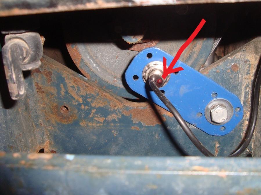

First I fixed the magnet on the front pulley with epoxy.
The sensor was fixed to the frame.
The tachometer was mounted in a plastic box on the top of the dashboard.
The wiring is straightforward.
What is important is that the magnet is mounted with the correct pole towards the sensor! Try first by moving the magnet back and forth in front of the sensor with power connected. If you get no reaction it is the wrong pole and you have to turn it around. I missed that and had to remove the magnet by force and mount a new one! :eek:

How close does the magnet need to be to the sensor?
11,026
2,897
somewhere I read .....
Power requirement:DC 12/24V
Measure range : 5-9999RPM.
Clear zero: Automatic.
Clear zero time:about 10s.the greater the RPM value,the longer the clear zero time.
Refresh frequency: 0.2-0.5S@120-1200RPM;0.25-0.06S@2400-9999RPM.
Measure indication:RPM<5000,±2;RPM>5000,±3.
Display:RED 0.56” LED
Sign:pusle signal,Hall NPN 3 wires normally open.
Hall proximity model:NJK-5002C
Appearance:M12mm cylinder.
Detection range: 10mm
Proximity output current: 200mA
Detected objects: magnet
Response frequency: 100HZ
Tachometer dimension:72x36x20mm,panel cutout Dimension:68x33mm.
Sensor dimention: M12x10x55mm.
Sensor wiring:brown-Power+;blue-Power-;black-signal.
Operating temperature: 0 to 50°C.

I was wondering do you need to worry about throwing the flywheel out of balance?
Not on a relatively slow moving diesel crank. If you were concerned, you could always glue a similar non magnetic weight 180 degrees on the other side.
With regard to the PTO mount, usually there is an inch of unused shaft, forward of the PTO coupler. You would just have to be careful on hookup, to not knock off the magnet...:D
