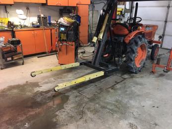

Spent a little time in the shop yesterday,welded brackets on my shop crane so i can move it with the kubota. Garage is small so i store tools in the quonset, dragging them back and forth across gravel. Needed something. 7F5F7B64-C05E-4C5A-8E18-2BB7C3CAEB89.jpg
Also did this to an engine stand,to move an engine from building to building.
Never thought a 3 point hitch would be so handy.
