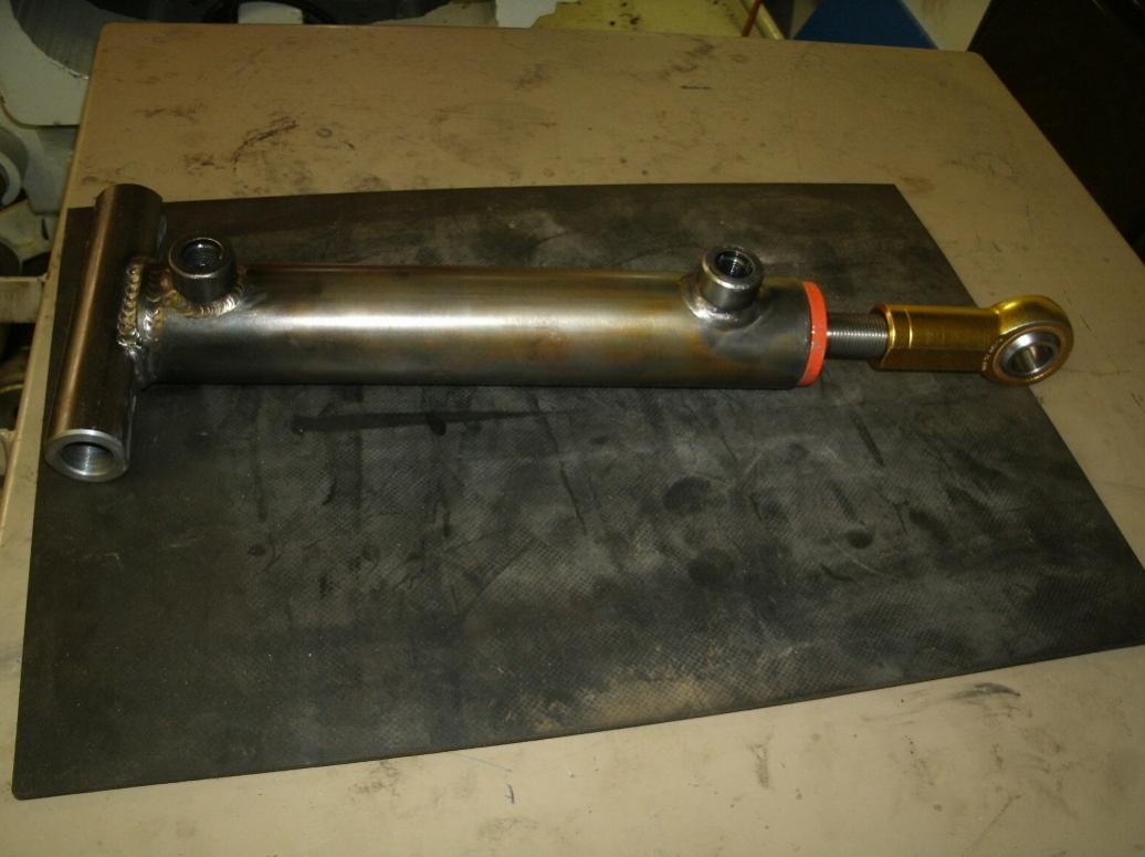

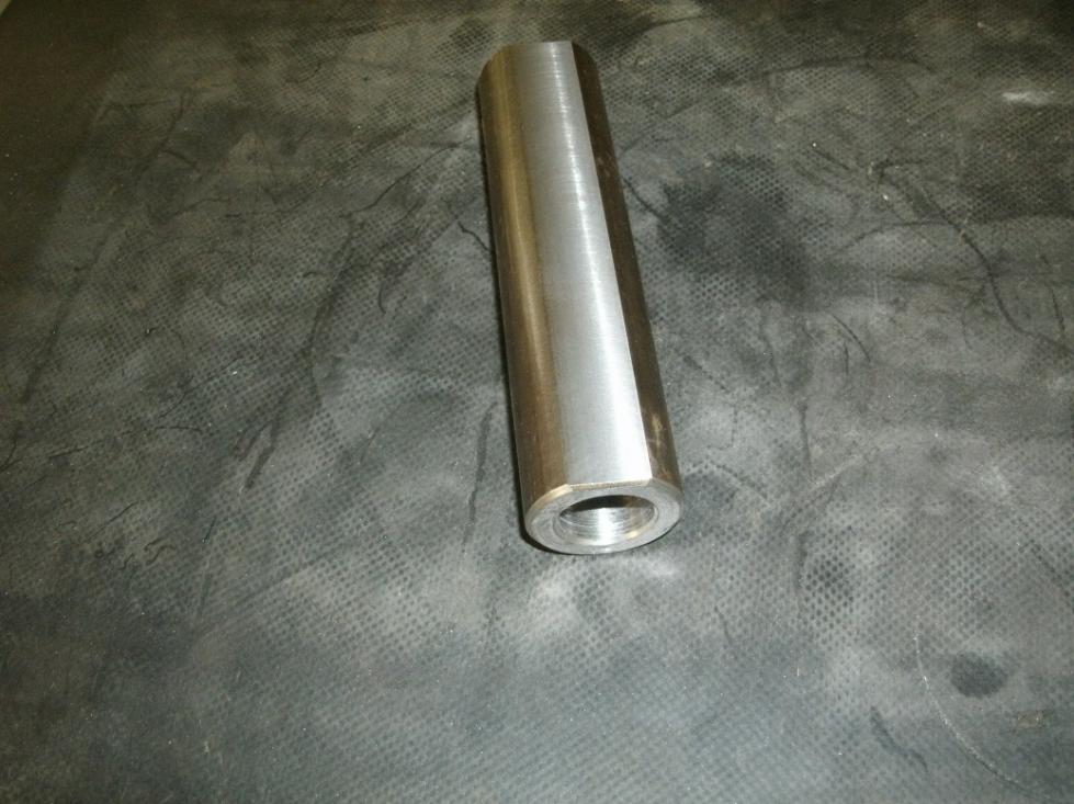

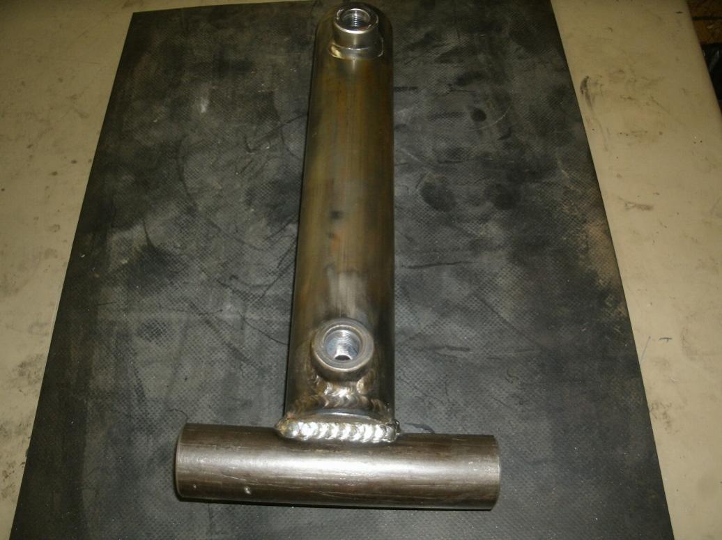

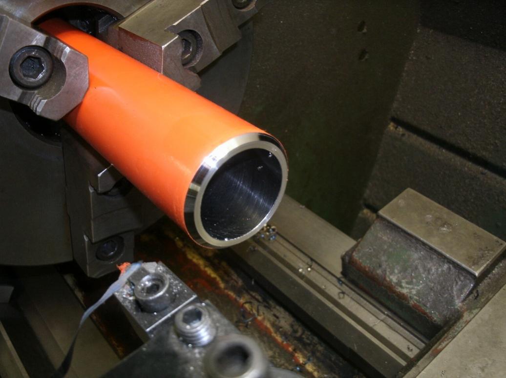

I thought I'd start a separate thread for modifying the hydraulic cylinder for my wood grapple build. I hope it will help somebody in the future who may want to take on such a thing. Also, this is one of those cylinders where the end cap is held in place by one of those rings that you have to 'roll out'. Helpful to see how it works.

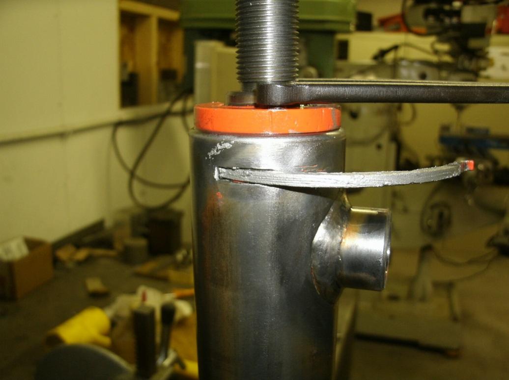

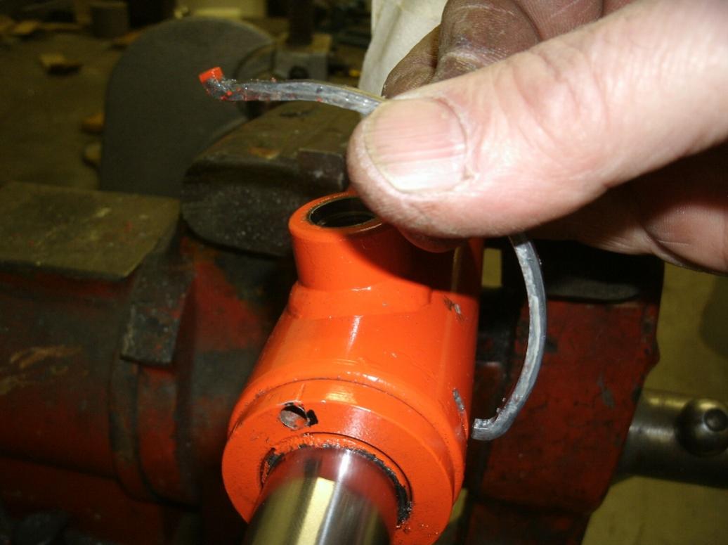

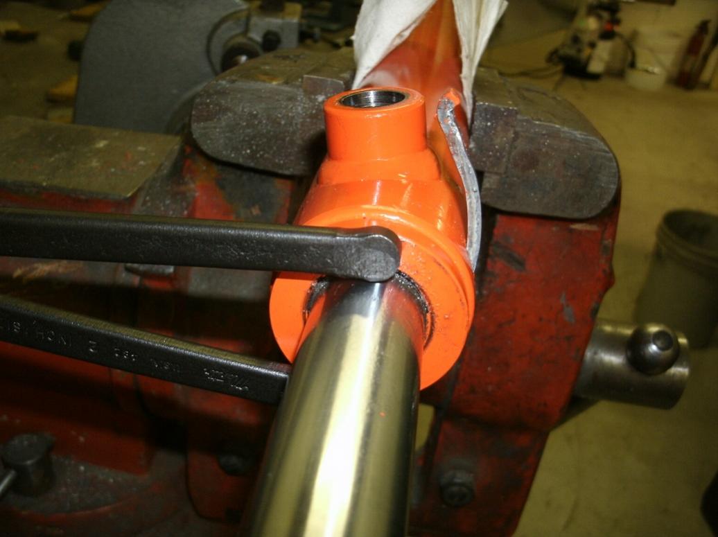

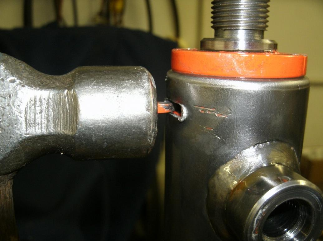

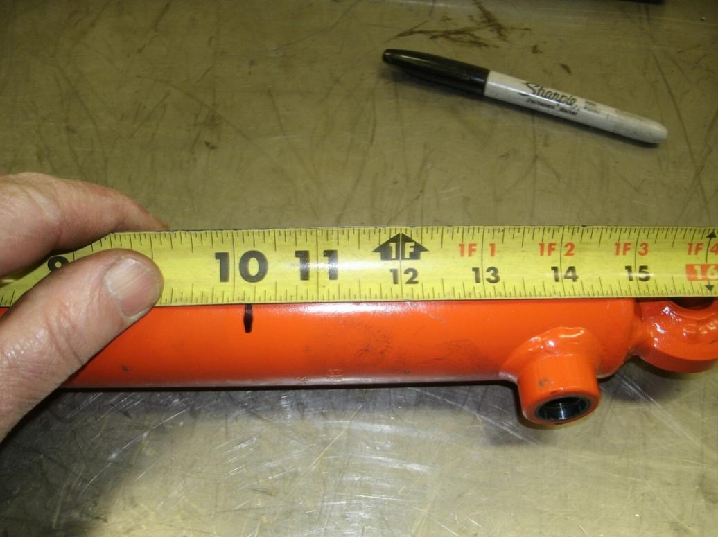

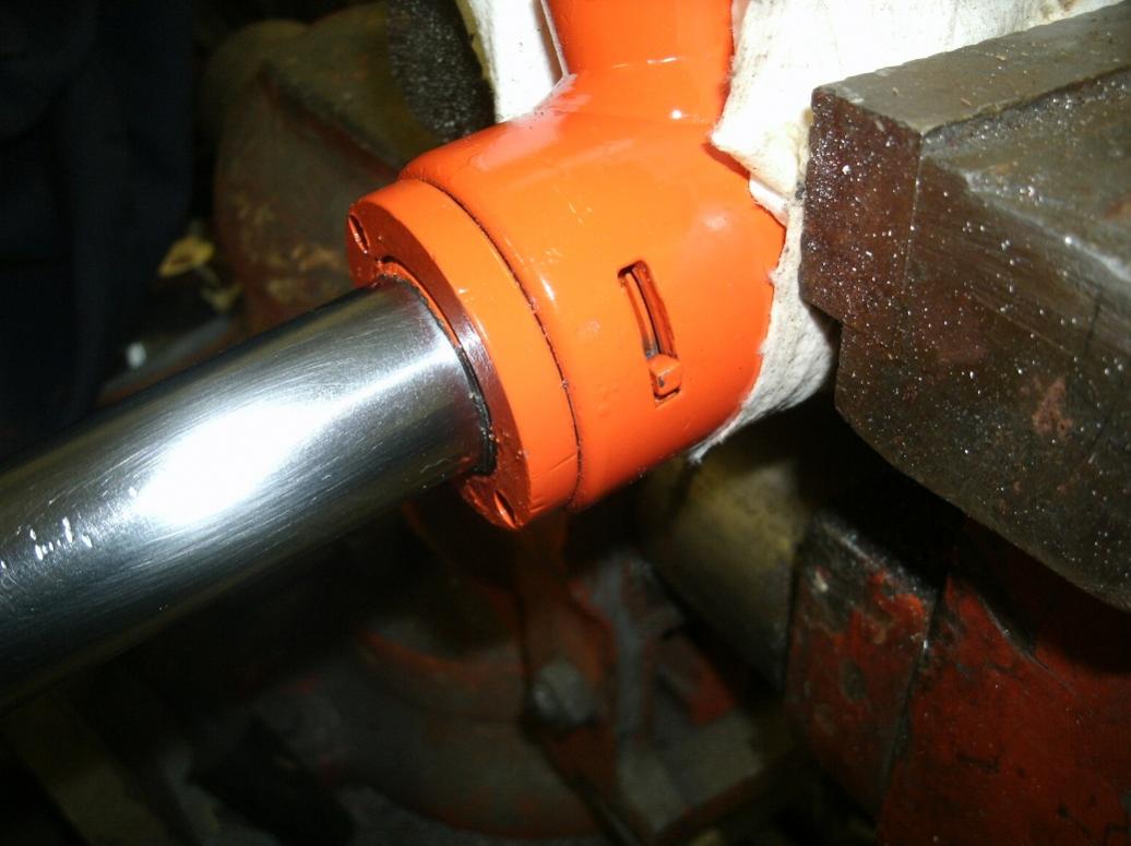

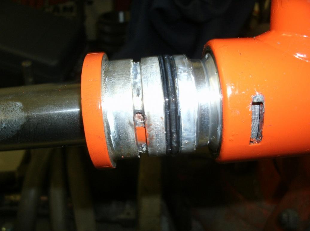

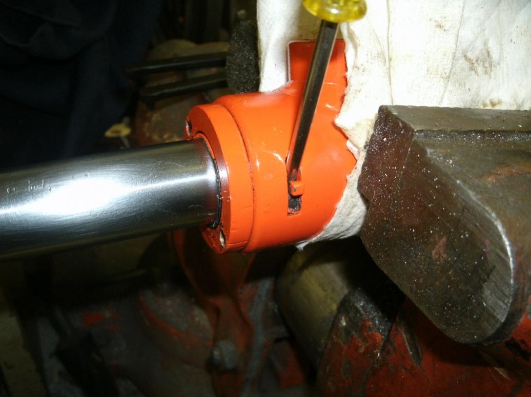

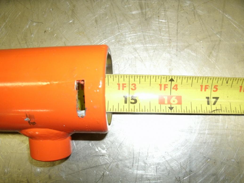

The cylinder I have is a 1.5" x 12" stroke, which I need to reduce down to a 7.5" stroke. The pictures are of starting to disassemble the cylinder. One thing I want to note is that I had to bend the retainer clip with a small screwdriver to get it to start out of the groove.
