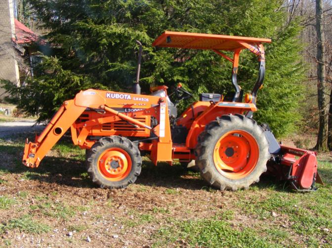

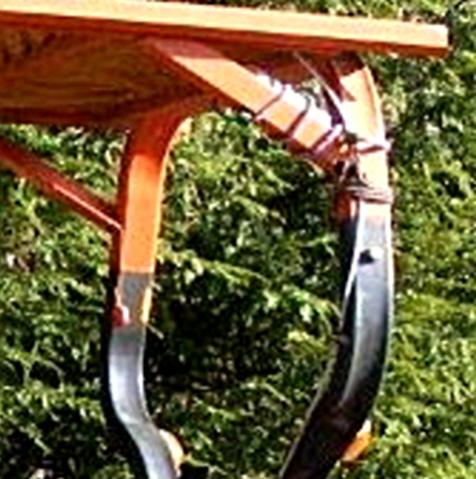

The ROPS on my L3000 is a 2 piece but doesn't fold. It has a metal piece on the inside of the tubing with nuts and one bolt top and bottom on both sides.
I looked for a better picture but you can see the bolt a little. Obviously you can tell where the 2 colors join, that's where it separates. I don't see why a person couldn't cut one into, shorten it and bolt it back together just like the factory did.
I understand the warranty issue but it's you tractor and if you need it shorter then make it shorter. If you do it the right way it will still be just as strong as it is now. Just don't turn it over and the warranty will never be a problem anyway. :D
