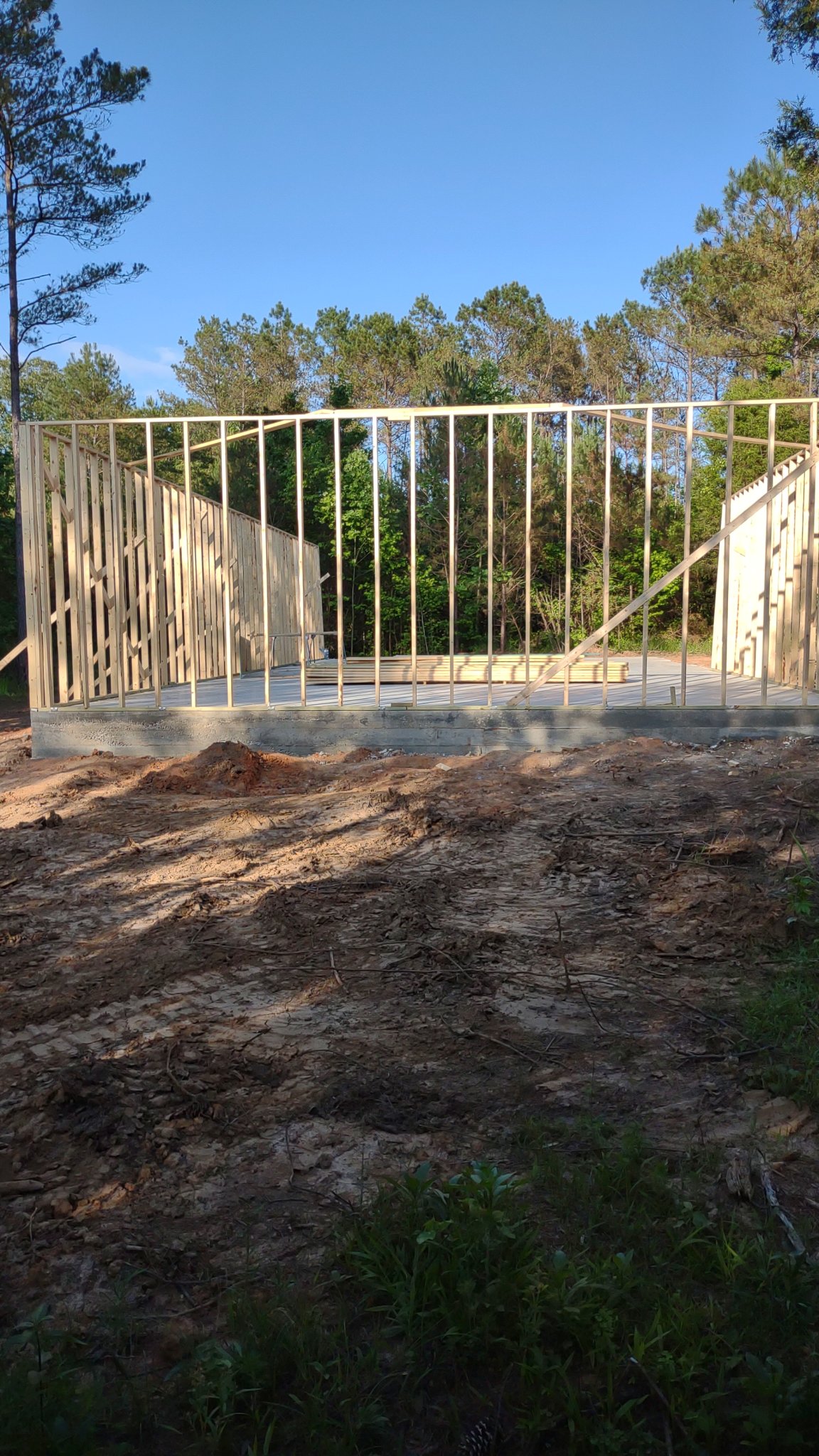

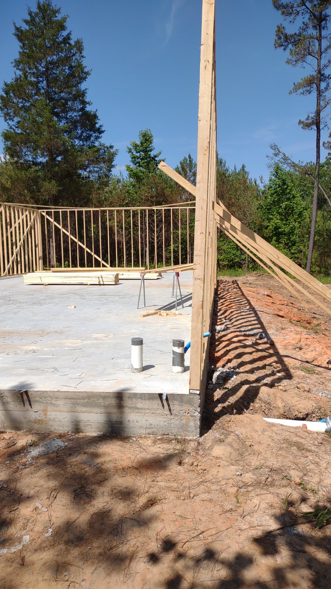

5/28, 29, 30 - day 3, 4, 5. Plumbed, squared, straightened, and braced the near end. Got the last frame up on one long side. Doesn't look like much progress, but we're getting there.

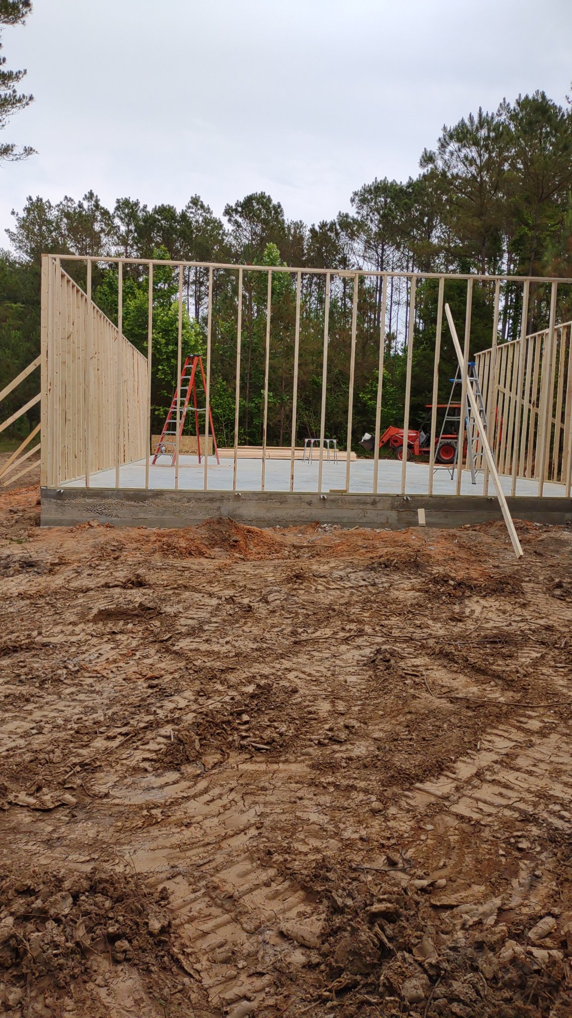

The shop looks really good. Keep your standards high. In the end, it will show in the finished building. Dad always said, “Do it right, or you will do it again.”
1 request, how about a pic from a corner down the long side? (I have building envy pretty bad)
Izzat what you meant? It's not straight/plumb yet. BTW, I'm using 2x6 top top plate to stiffen the wall since there aren't any lateral walls to help out.

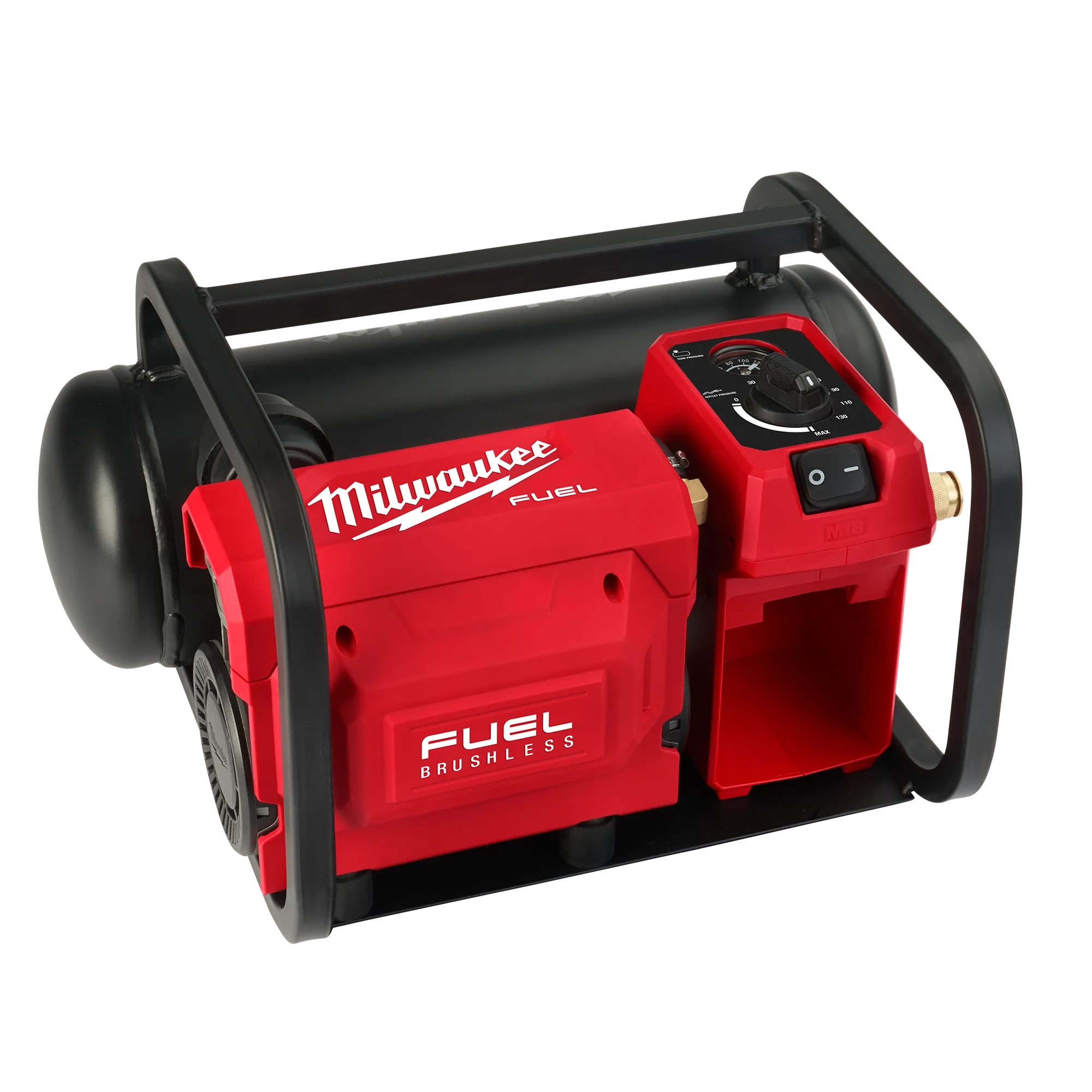

I have about 25 of air nail guns and I wanted to be able to take them on little jobs, But hauling the big compressor was such a pain.
I ended up getting a battery operated compressor.
One battery will run a framing nail gun about half a day of moderate use.
It will run a trim nail gun all day.
Hmmm. I didn't really think about that. That's what I should have done. The only Ryobi compressor is 18v, rated at 0.5 cfm. What compressor do you have?
