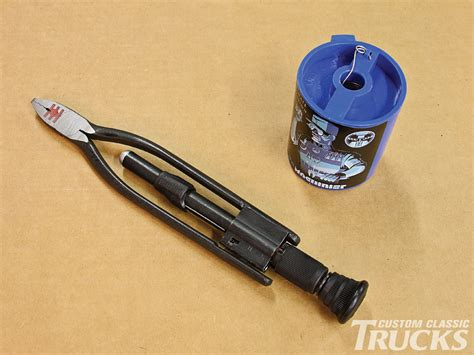

2 wraps of something ironically called, "safety wire", and my switch hasn't moved in a year.
Took me longer to find a pair of dykes to cut the "safety wire" than it did to close the switch and wrap it.

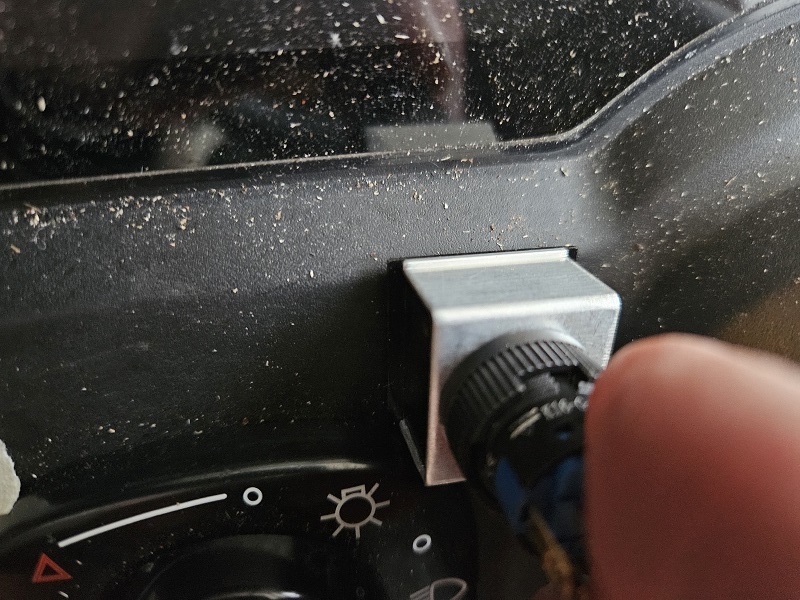

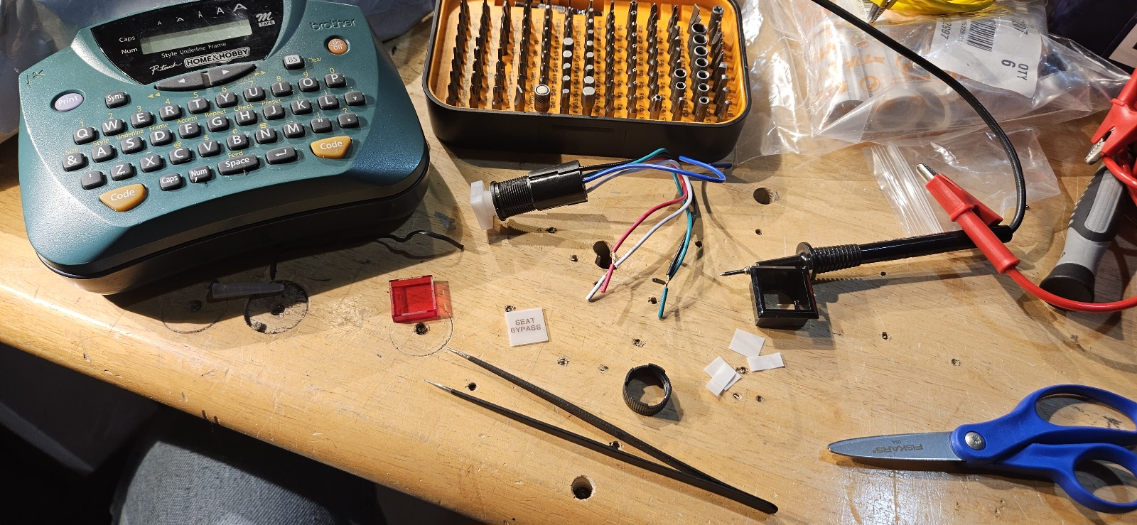

Made a little progress with the limited free time this weekend. Took the switch apart, tested everything, made a label, assembled. A friend said since it's a custom switch it should say, "A$$ BYPASS" though I'm not sure that's a good idea.

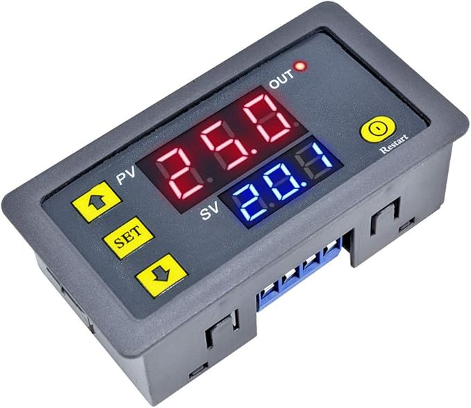

I would look into something like a timer relay to let me get passed an area the seat switch was getting activated on. I would want the timer to de-activate the bypass for only a short period of time and default to using the seat safety switch.

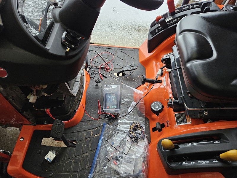

I dug into the dash today, pulled the delay timer harness and found only 1 of 2 seat switch wires there, so I'll have to look further into what's going on in an electrical diagram. Kind of hate cutting holes in the dash until I know exactly what I'm doing.

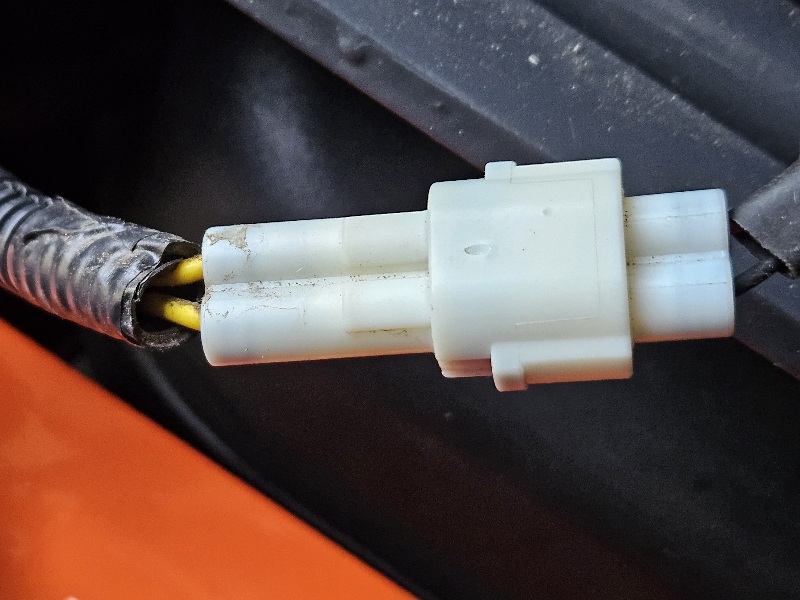

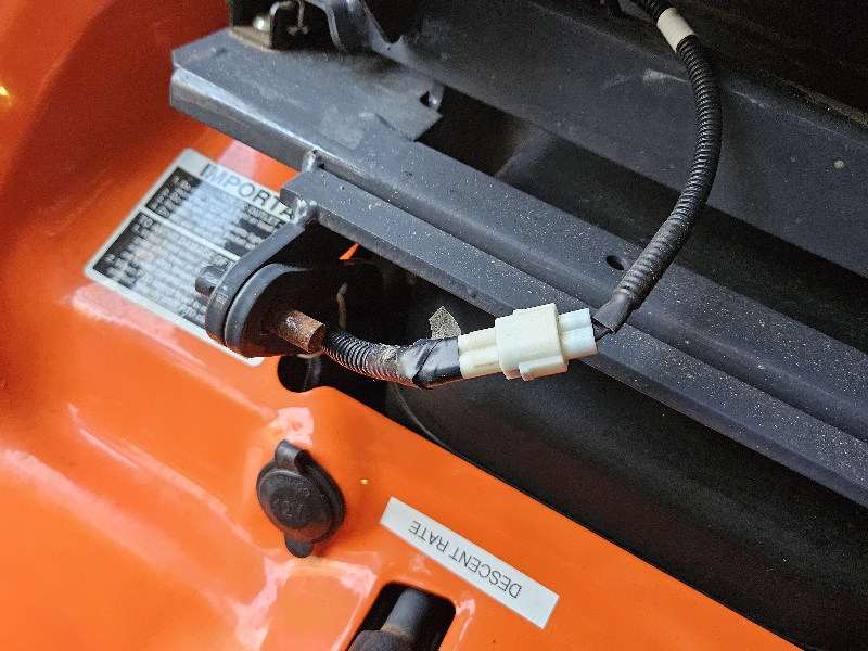

The BX2370 seat has a plug for the Seat Occupied switch.
which should in theory have two solid yellow wires going to the Engine Shutdown Timer.
One of the two wires
traces to the timer plug and a striped wire
under the dash,
and I can't find where the other goes in order to short the "source" and "return" like the seat switch would do when the seat is occupied. Trying to find a wiring diagram on my phone in the woods with little cell service and 15F temps isn't going well, is someone able to tell me where the other wire is or if I'm on the right track?

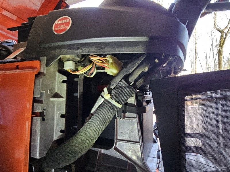

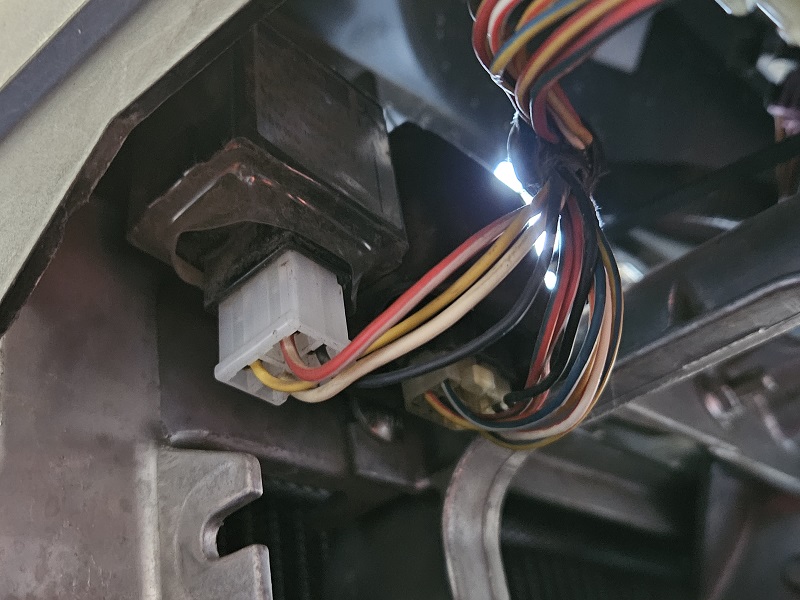

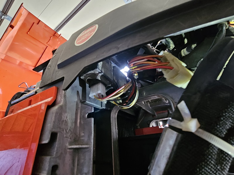

A slight recap for the crayon munchers:
I started by pulling the tape off the operator present switch.
Yellow and Yellow--not good.

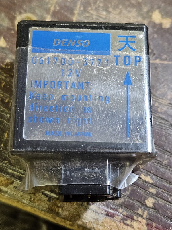

The seat switch should eventually go to a timer relay so a slight bounce off the seat doesn't kill the engine, and that timer is under the dash.
The timer is attached to the plug furthest left--no need to remove the timer, just the plug.
-->I<-- didn't know which plug went to the timer, but now that's solved.

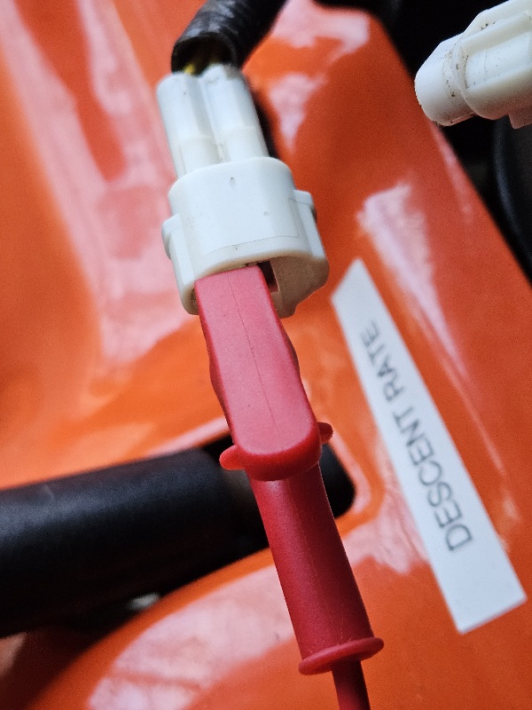

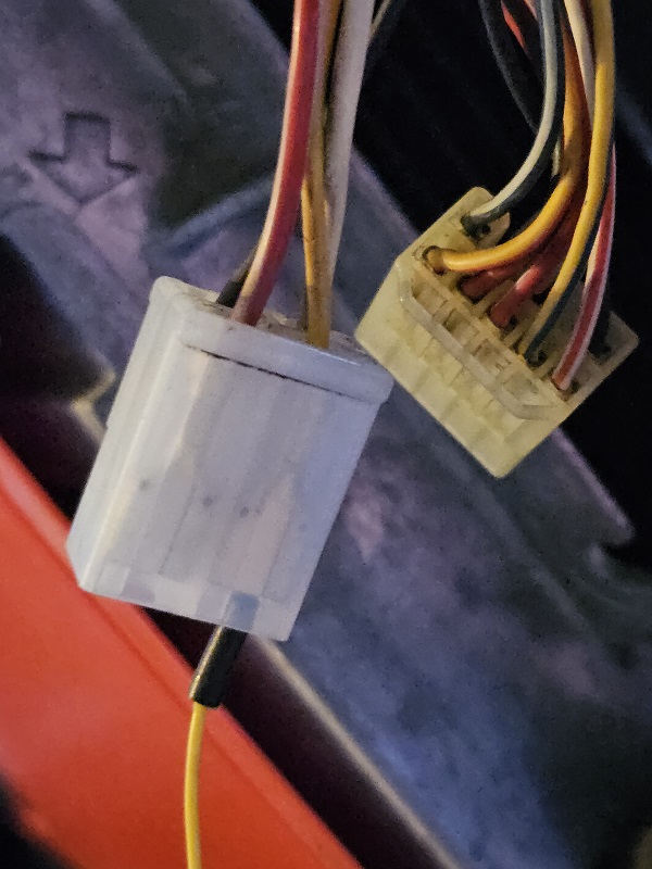

The yellow wire (the left yellow wire, not the right yellow wire) shorts back to the plug and is not energized with the ignition off. The trick to figuring this out is to turn the ignition on and realize it goes low (zero volts) when the seat is unoccupied and another condition (like implement) is engaged.

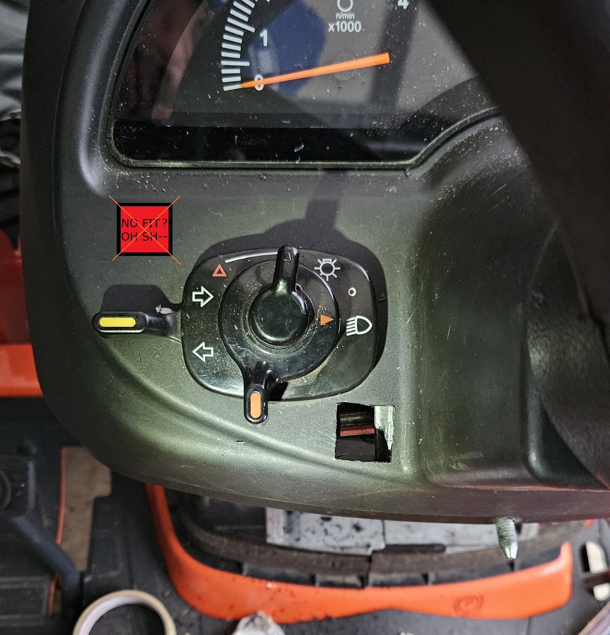

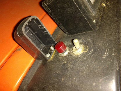

With the wire located the switch can be conveniently mounted in the dash, though finding a location is a bit problematic due to space considerations--it didn't fit where I wanted it if the turn signal switch function is retained.
Not enough space here either.
WI_Hedgehog
Apr 24, 2024
1,130
1,647
Milwaukee, Wisconsin, U.S.A.
The right side of the dash is cramped underneath with "stuff," let's leave it at that. Practically speaking the switch is best located on the left, though there are obstacles to avoid on the left side also.
I widened the hole and cleaned it up, and in the dark at 15°F (and wind) this looks straight both from the side & driver's seat. (Maybe it actually is, that's a job for the inspector and above my pay grade.)
The hole cannot be "tuh-tight" (or "fuggin' snug"--that's horrible!), even if the switch fits it cannot bind or it will be permanently "on."
Wiring it so it does more than look pretty...that's the electrician's job. I just left the seat switch plug unplugged and "jumperered it." 🤣
