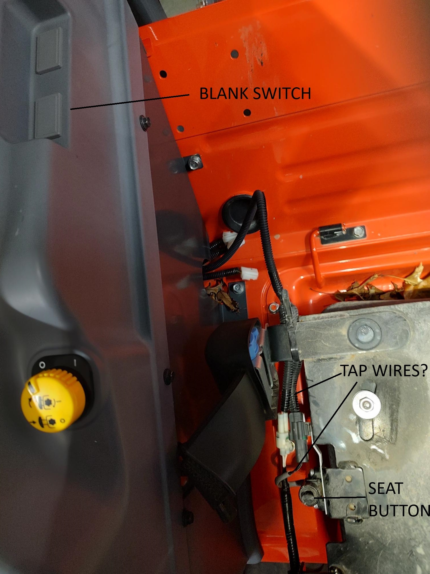

I would like to bypass my tractor's seat safety function with a separate on/off switch. I don't want to have it permanently disabled. Tractor is a 2023 Kubota L4060 ROPS model. I've attached a photo of the wiring. You can see where the safety engage button is located and where I would install a switch on the blank plate. My question is where do I tap into the wires, just after the button, or on the other side of the gray connector in the line? Also, I guess I have one other question...is this the only safety function, or is there another "switch" located inside the seat? Thanks.

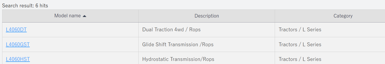

You would have to give me the actual model your working on, as there are several L4060 ROPS units.
I will only tell you if there are mutiple safety switches which there probably is.
I will not tell you how to bypass it.
And FYI your dealing with a computer controlled tractor, get shorting out wires wrong and your very very likely to fry the ECU

as for 'how=to=bypass', 1st get the correct wiring diagram for your exact model tractor.
I can't tell from the picture if that 'seat switch' is SPST-NO, SPST-NC DPDT-NO_NO or SPDT. What type it is does make a HUGE difference as to HOW you can bypass it.
Since some need to bypass switches, manufacturers have gotten clever using something other than a simple SPST switch(2 wires). In the early years ADT used SPDT switches for their alarm systems,making them impossible to defeat when connected to a control panel with window comparator inputs.
Why some won't tell you how to bypass ? , is for legal reasons. If 'A' tells 'B' ,do 'this' and 'B' gets maimed, 'B' could sue 'A'.......
