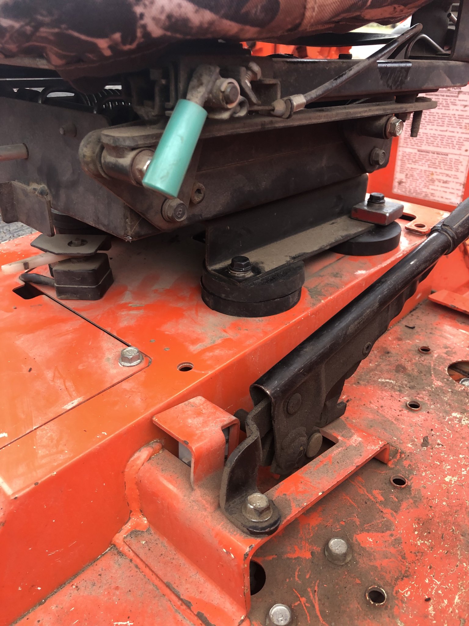

OEM seats leave a lot to be desired. I’m a big guy with big feet. Finally spaced up and tilted back the seat on the M59. 2” rise on the front and 1” on the back with 1” thick rubber blocks. Made a world of difference in comfort and position. Much kinder on the back and knees.
I’m maxed out on the spring tension. Might be a place to add some cushion rubber when bottoming out. So far not as big problem as seat position.
Do have a seat cover. Might try an extra cushion under the cover?
Spacer may work. I’ll try it
