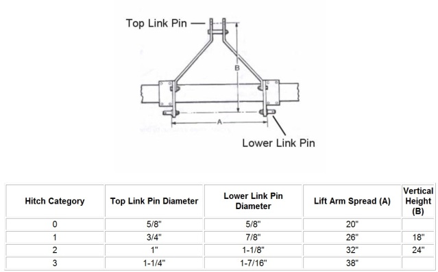

IDOL north Wolfman yes i have 3pt hitch my problem now is i need to modify it to like this one i need the dimension please anybody thanks i appreciate it.,,:D

I guess Im missing something here. If you have the plow already and a 3pt hitch I cant see why it would be a problem setting it up to the 3pt, if its to wide you just measure it ,,if I am not mistaken the with of the pins should be between 24 and 28 inches if I remember right,,, the height should be about 16 I think,, again I could be way off base with these numbers and I mean WAY off base,, but still if you have the plow you should be able to fudge the ting

pin<------------------------------>pin is 24 to 28 inch do you have single buttom plow please.. can you measure please if you have time i appreciate it :D i just want it to fabricate almost same as the original so the height from base to top of A<-- is 16" i start cutting it tommorow thats why need some infos thank you idol skeets

somebody say this
26 in wide and 7/8 lift pins, 3/4 top pin, 18 in height for cat I
32 in wide and 1 1/8 lift pins, 1 in top pin, 24 in height for cat II
38 in wide and 1 7/16 lift pins, 1 1/4, 27 in height for cat III. The height can vary to suit the equipment.
and somebody say this one
Category Hitch pin size Lower hitch spacing Tractor drawbar power
upper link lower links
0 17 mm (5***8260;8") 17 mm (5***8260;8") 500 mm (20") <15 kW (<20 hp)
1 19 mm (3***8260;4") 22.4 mm (7***8260;8") 718 mm (26") 15-35 kW (20-45 hp)
2 25.5 mm (1") 28.7 mm (1 1***8260;8") 870 mm (32") 30-75 kW (40-100 hp)
3 31.75 mm (1 1***8260;4") 37.4 mm (1 7***8260;16") 1010 mm (38") 60-168 kW (80-225 hp)
4 45mm (1 3***8260;4") 51 mm (2") 1220 mm (46") 135-300 kW (180-400 hp)
http://www.tractordata.com/articles/technical/threepoint.html
i have b7001 that i believe cat 1? does i am right
26" or 20" or like idol said 24 to 28.

yeah i dont have problem with the attachment. reciever tube are limited available on my area, my concern was the original width" i cant make the width same as that TSC subsoiler the intendly for the B2601 my tires are narrower from that.
34,614
9,844
Width is supposed to be 26" to 28" for cat 1
Your problem is you can't get that width because tires are too narrow, Simple fix move the hub and make the tires wider.
Or just make your implements narrow like 21" if you really need to keep the narrow tire width. ;)
Thank you I appreciate it, going to cut it now

yeah thanks sir but im aint working in garden i use the plow in a sugarcane furrows thats why i need it adjustable left and right.
thats why i need to make my tires narrow,
i tried 25" need cut the 2x2 wood (pattern) to again i just maximizing the lenght of the bar
