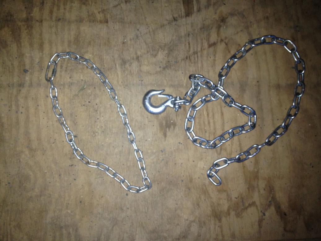

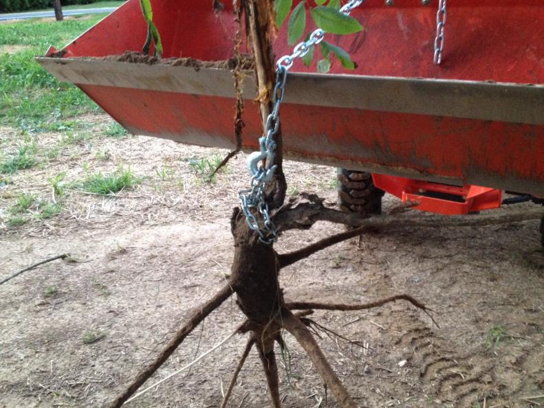

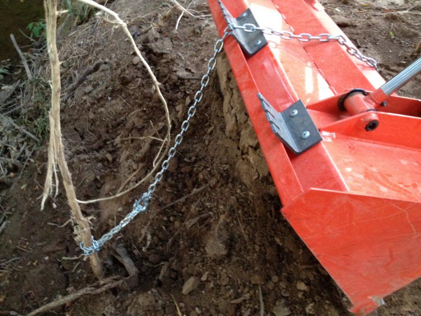

We bought some land that adjoins ours last Winter. Finally had a chance to start work on it last week. I began cutting off the low tree limbs and removing brush along the creek. There are a lot of saplings up to about 2" or so in diameter that need removed. Scraping with the buckket worked OK with the smallest ones. I didn't want to cut them and leave stubs sticking up so it looked like pullling them out was the answer.
On the way home this evening I stopped at a hardware store and picked up some pieces of chain, a safety hook and a repair link The 1/4" chain is rated at 800# and the 3/8" at 1340#. I would have liked a higher rating on the small chain but thought the smaller links would work better.
The small chain is in a loop that I wrapped around the saplings and took the end of the chain through the loop to form a sort of slip noose. The slip hook garbs the looped end and thr plain end is dropped in a slot on my homebrew "bucket hooks".
At little more than an idle I kept lift pressure applied while slowly moving the Kubota forward and backward about a foot or so. The saplings pulled out without much of a struggle. The chain loop wanted to slip on some, so I re-wrapped the noose to take advantage of nubs on those.

I run the chain back over the top of the bucket and then forward under it so the chain dosen't ride up the trunk of the small stuff. Usually take at least a couple wraps to get a good bite.

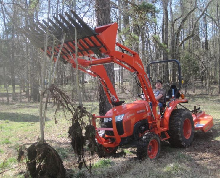

I finally got to use my logging tongs I bought at tractor supply six weeks ago. They latch on and hold. I hauled 8" stuff up to 18" oak....they work really really well...

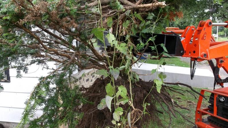

It is pretty involved/complicated/precise. If you want to fool around with CAD-WARE I am sure you could come up with something. That is what I did. There are so many clearances to take into consideration that it is not just a thumb on a bucket sort of thing. I probably won't post any diagrams as I intend to market this in the near future. It also does 55 gallon drums but that is not quite as exciting as ripping stuff out of the ground! Here is what I pulled today.
