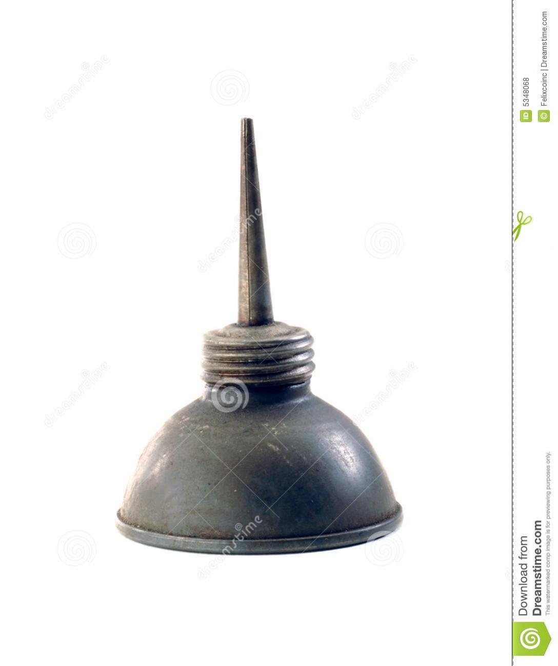

I saw this on one of the boards and used it last year on the bolts of my Ford tractor's muffler flange bolts. My mix is in an old-fashioned metal oil can (push the bottom and it flexes in and out). Gave it a few applications over several days and it worked well. I mixed the ATF & acetone in a glass jar and it didn't appear to really mix. The two liquids wanted to separate. It did work like a champ.

bxray,, forget that spray bottle. The acetone will destroy the plastic. You might get by with a 60/40 mix.
Thanks for the info.
I will get an oil can.
Or maybe two to keep them seporate.

I guess this is my first post? maybe,.. cant remember that's bad,... Anyhow the acetone and atf works good I have the Kno Kroil as well. Just remember to keep the mixture tightly sealed when you are done or it will evaporate faster than zippo lighter fluid. The tin oil can is a great way to use it but don't leave it in there or all you will have is atf. Good luck Yep first one,.. Hello all !
