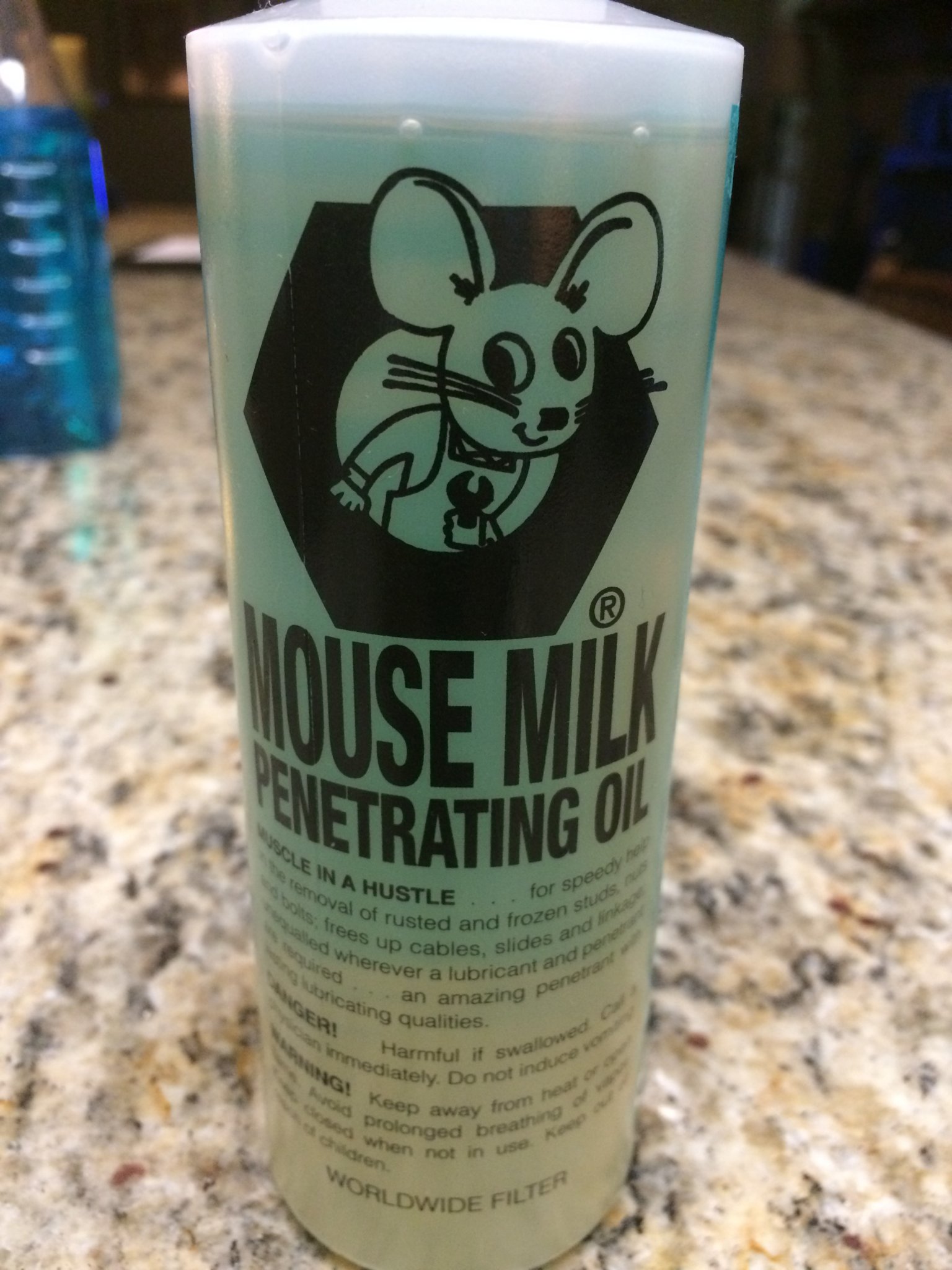

My bottle of Mouse Milk came today but my application is 46 miles away at my property/tree farm, so it will be a few weeks before I can trial it. Mouse Milk is highly rated in the aircraft industry.
I will be busting the bolts loose that hold the gear boxes on my Bush Hog, one of which has a broken output shaft. Gonna be a chore.
