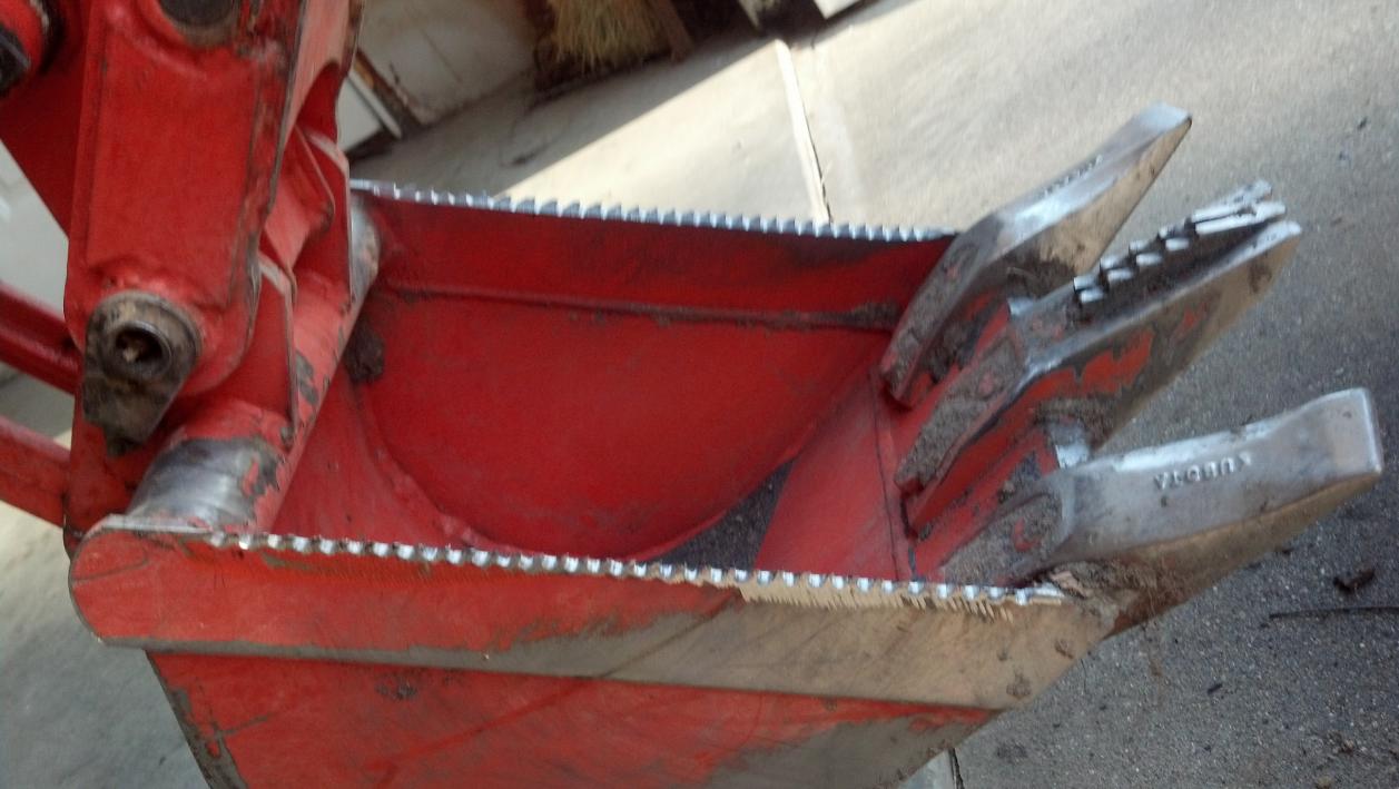

This helps a lot for cutting through roots . Used a grinder and cut teeth into the bucket sides . I also made a tooth for the middle of the bucket that allows me to peel through the big roots .

As i was gnawing through those roots, i was thinking the same thing, a few points and sharp edges and it would have made the work easy.

That is so cool! Bravo dude.
Thank you . The only down side to teeth on the bucket sides is when you try to spin the stump as was suggested earlier , tends to cut the roots off , lol . But still a lot better .
