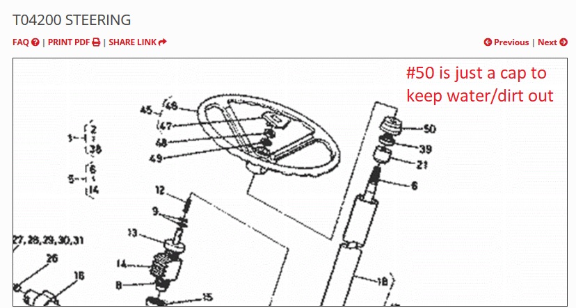

Ok, so this has been a bear to get loose using some of the alternative methods. I have a 3 jaw puller hooked up to it now. It still seems pretty tight. what I want to know is do I have the jaws pulling the right part of the wheel or do I need to drop down to the lower black part? PLEASE EXPAND THE PHOTO. It doesn’t show the entire picture (at least on my phone).
The lower part in your marked up photo is just a plastic cap to keep dirt out.
If you are determined to mangle your wheel with the three jaw puller, why not use a hacksaw or angle grinder to cut back the steering wheel plastic to try and expose some steel to hook unto with the jaws

You may be able to put some spacer between the puller and steering wheel hub to avoid the plastic that extends below the hub. That may allow the puller to work without mangling the plastic.
