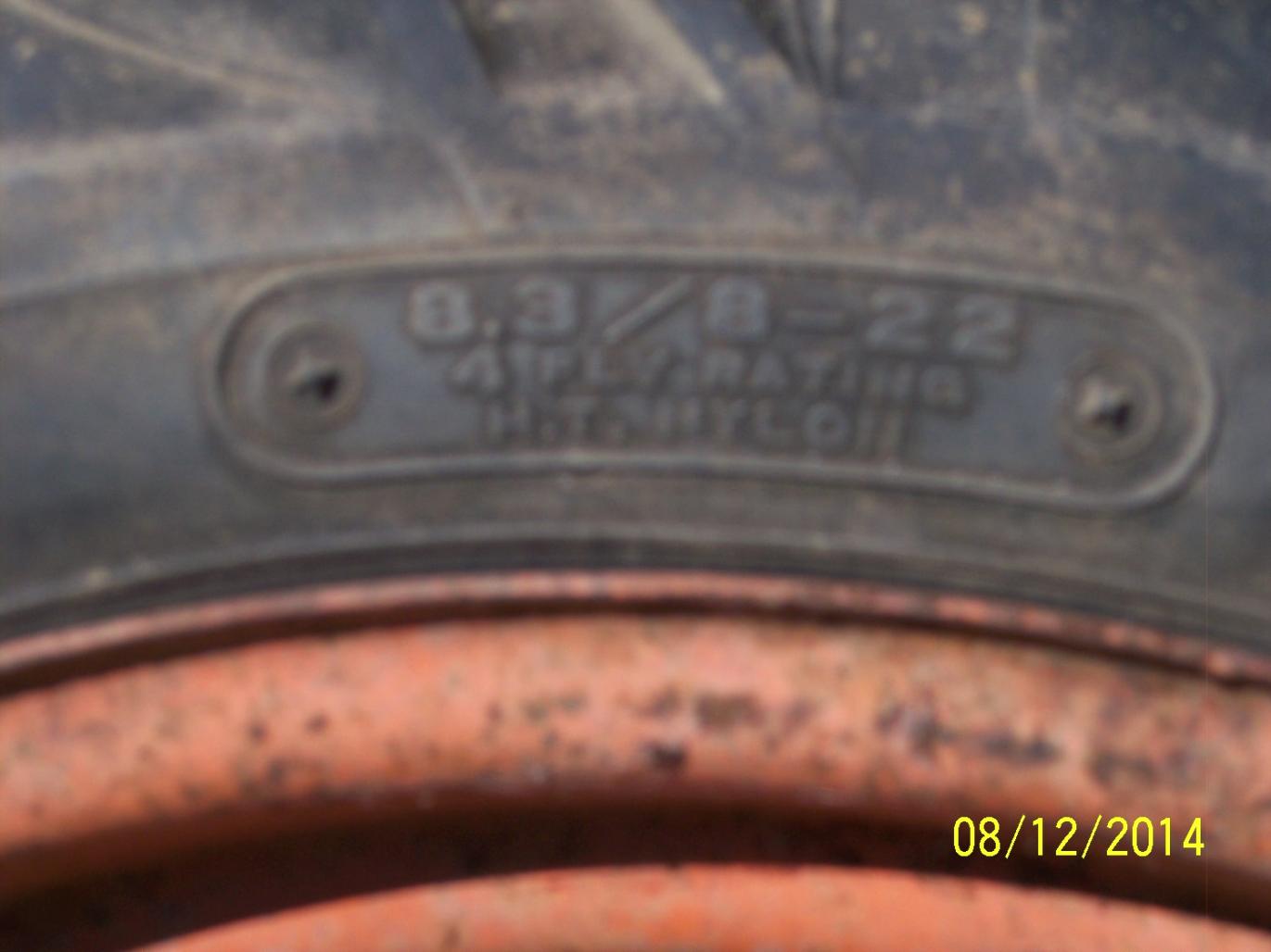

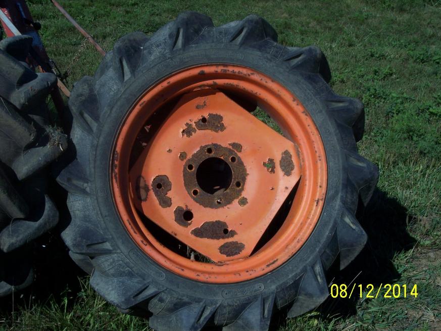

I've got a pair off of an L1500 I'm not needing/using. Don't know if they are the same width as you need but I do know they are 22". One has a good rice tire on it. One has a BAD rice tire on it!
I'll check to see what the tire size is.
I edited this because I said they were 24" and they are 22".
They are likely 8.3 x 22 and cost $400 each to replace.

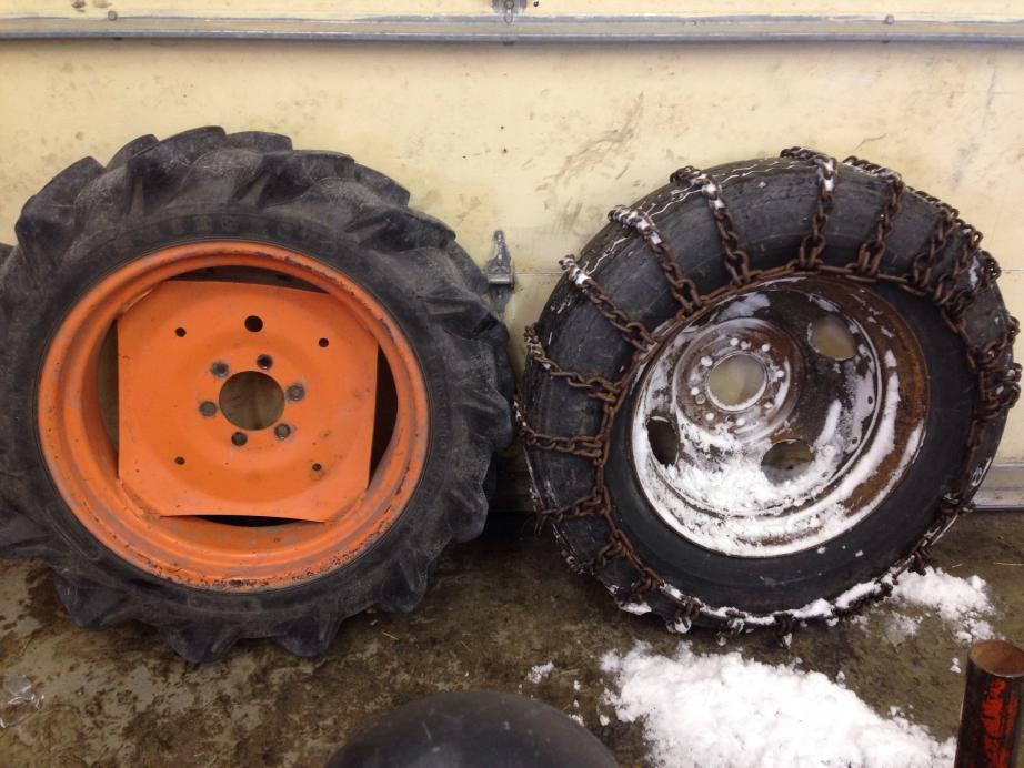

I'm switching my tires over today and thought I would send a picture of the route I took when dealing with the exact situation you're in right now.
It was less than 400 bucks if I remember correctly.
