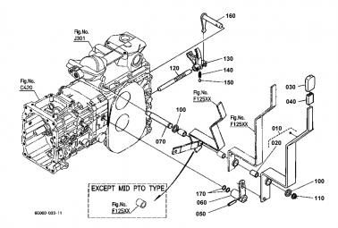

SO - the N closer to L/M is really the M if I understand correctly?
If not the lever bent - is something the lever connected too bent? Did you trace it all the way back to the transmission case?
Look at this diagram and see if it matches to your machine
Yes it does look like your diagram. I did trace it all the way back. I removed the rear wheel to get a close look and it really didn't look like anything amiss.
The N closer to the L/M is really L.
So it appears to me that if the lever was pressed forward very hard towards H range and it bent the lever, then that would explain it.
